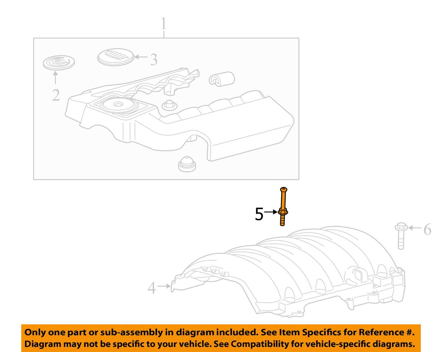

Johnny01: my truck doesn't have the studs.I ordered a set of two and received them today. Thanks!!!

The threads on the ones I received look like screw threads and not bolt threads.Johnny01!!

I think there is no bolts,, just a bulbous end so it just snaps in place with pressure , you may have the wrong studs you need bolt threads for the intake side of the stud

Johnny01: Do you know the part number i need for my 2016 chevy Silverado 5.3l V8 4x4?

22 hours ago, mikevickers10 said:
The studs highlighted in red in your photo, are they the ones required for the overlay? Or are they the ones that were on your truck prior?
My '17 never had the 2 studs. They are the only ones required to add the cover.

As I said in my first post, the GM part number is 11611691.
Johnny01: went out and took a look at my intake cover, which I should have done to start with. I found two offset bolts that hold the intake cover down, I replaced them with the studs I ordered and lay my cover on and it fit perfect. Sorry I bothered you buddy!!!
