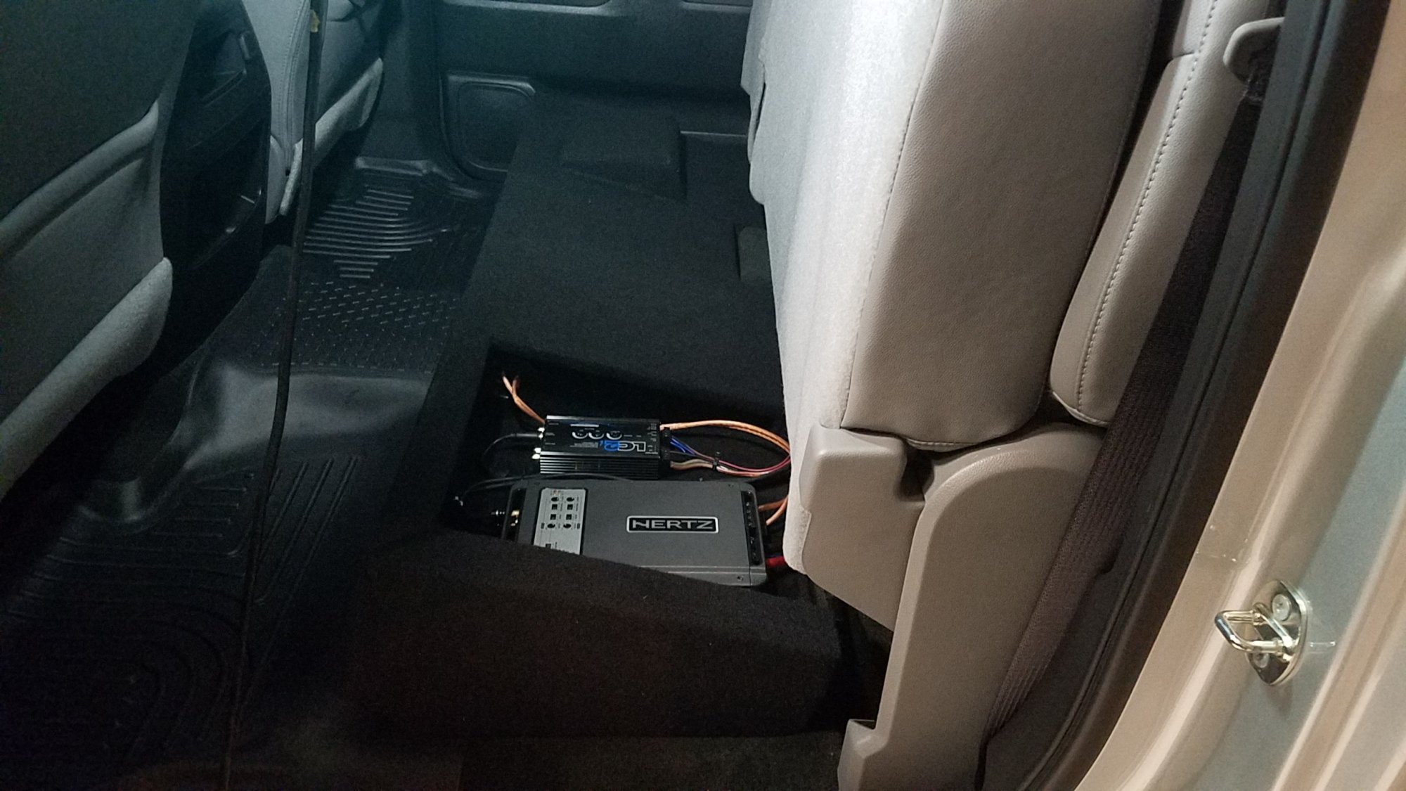

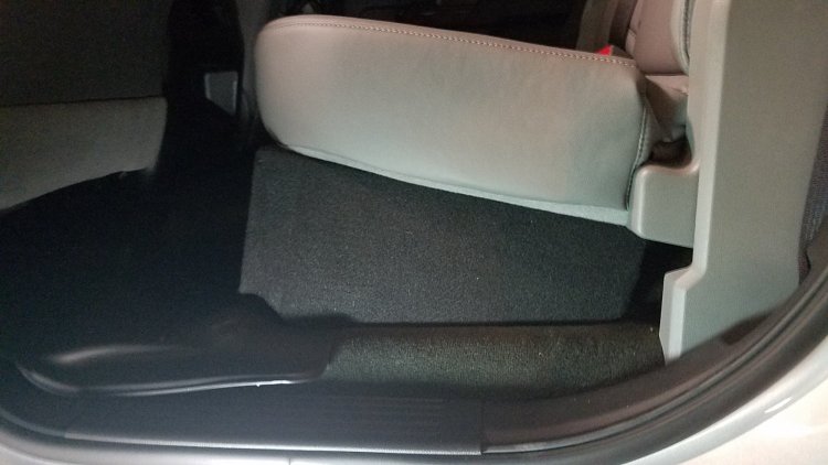

I just finished an install in my 2018 crew cab.  Used a box from subthump.com.  This one: http://subthump.com/Chevrolet-GMC-Custom-Subwoofer-Boxes/Silverado-And-Sierra-Crew-Cab-Custom-Subwoofer-Enclosures-by-Subthump/2014-Up-Crew-Cab-Large-Single-Downfire-Box-With-Amp-Space-New.html  Construction quality of the box is very high and the fitment is also very good.  I do recommend this box if you are looking for a pre-fab box.  Communication was good with Steve, owner of subthump.  I emailed him a few times to confirm fitment of my sub, which was outside of the specs listed on his site.  I used a memphis pr12 with 5.25" mount depth and 6" magnet.  I ordered box on a Thursday, it was at my door next Tuesday.  Here are the only few pics I have for now.  Was dark and raining when I finished, so I'll have some better ones soon.
Man, I bet that ported 12 sounds nice!
