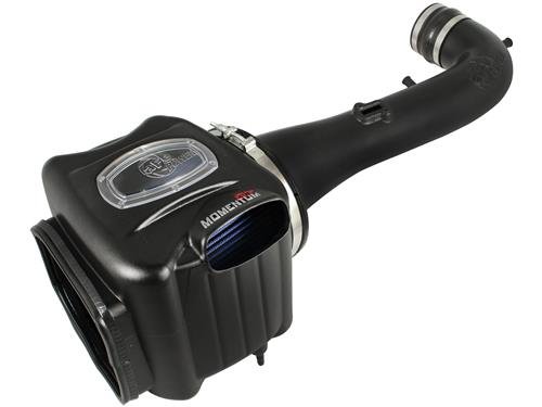

AFE/Advance Flow Engineering 54-74104 CAI

I just installed mine yesterday along with a Diablosport tune. Install is quick - maybe 15 minutes if you have the necessary T-15 bit to remove the MAF sensor. Makes the intake growl a bit upon throttle. My kids love it - sounds like a Vette. The combo really woke up my truck. Seat of pants maybe 25 hp between the two.
I was also considering the Volant and SBS - both $100 cheaper on Amazon, but the smooth taper of the intake tube was unique on the AFE which in my mind would improve flow rate and reduce turbulence to the intake
For those using the AFE - do you use the plug or not? I left mine plugged
I have that intake.  You need a longer silicone collar for the connection between the tube and throttle body.  4" long. The one it comes with is like 3" long
