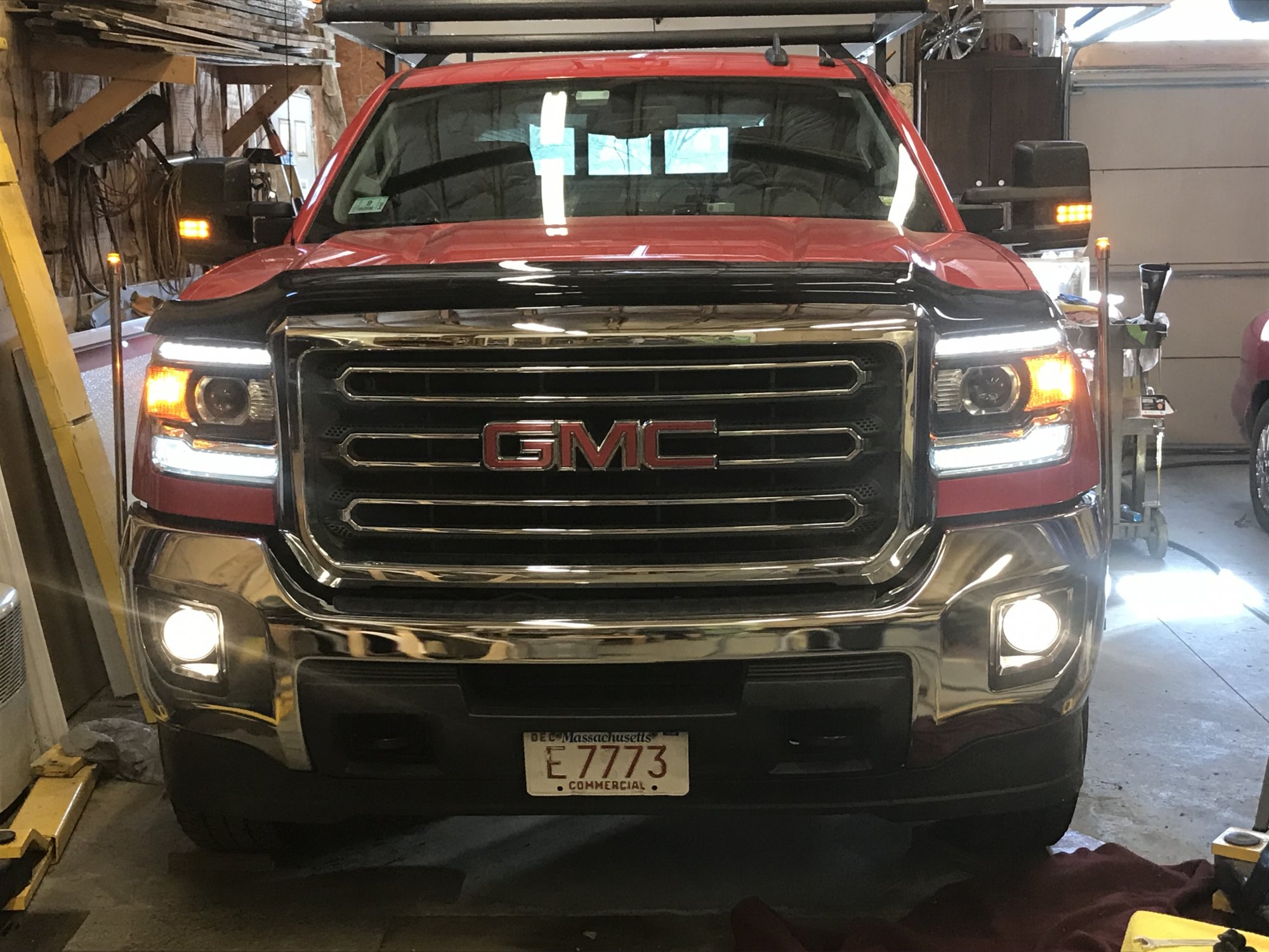

I have a 2016 W/T no fog lights , bought a set from ebay , had to take off bumper to install them , they look awesome just like factory ,
Honestly, I’d just stick some oem led fogs in the new bumper and just wire them up to a separate switch. They’re weirdly shaped, so without any metal work, nothing aftermarket would look good in there. You could always open up the factory fogs and wire in some nichia leds and be the guinea pig. Lol!
