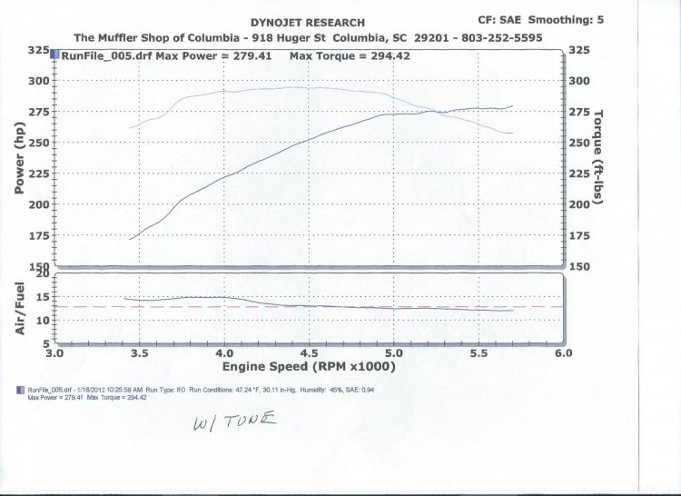

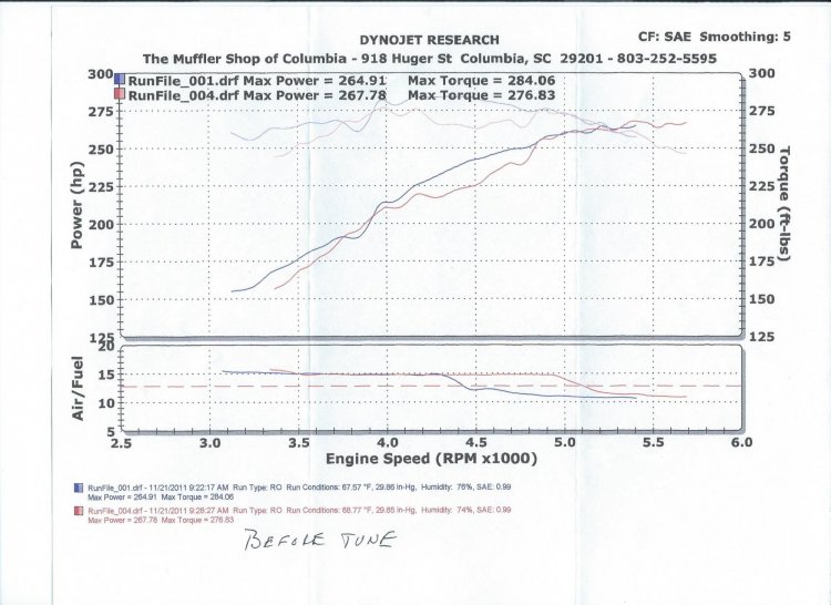

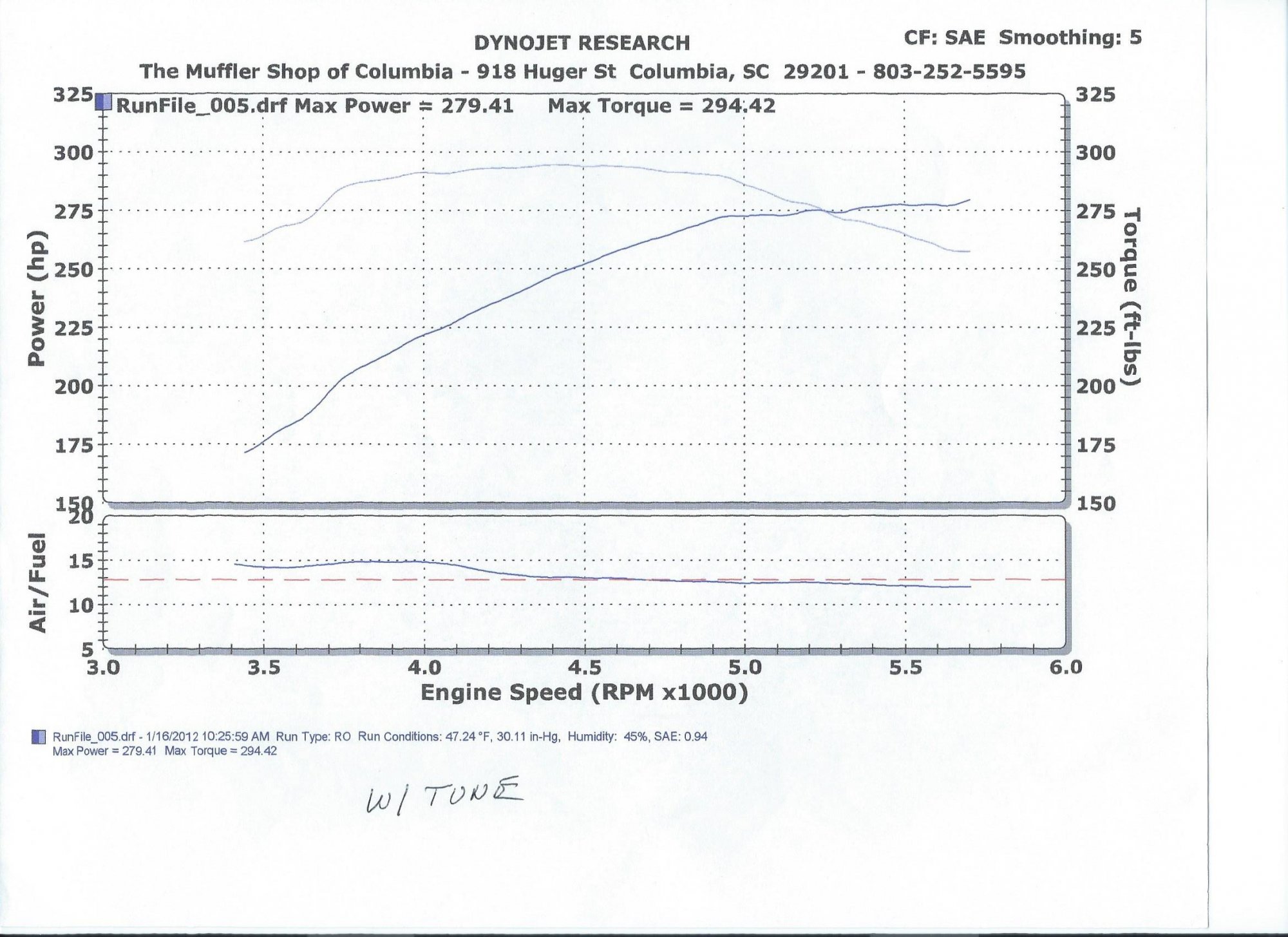

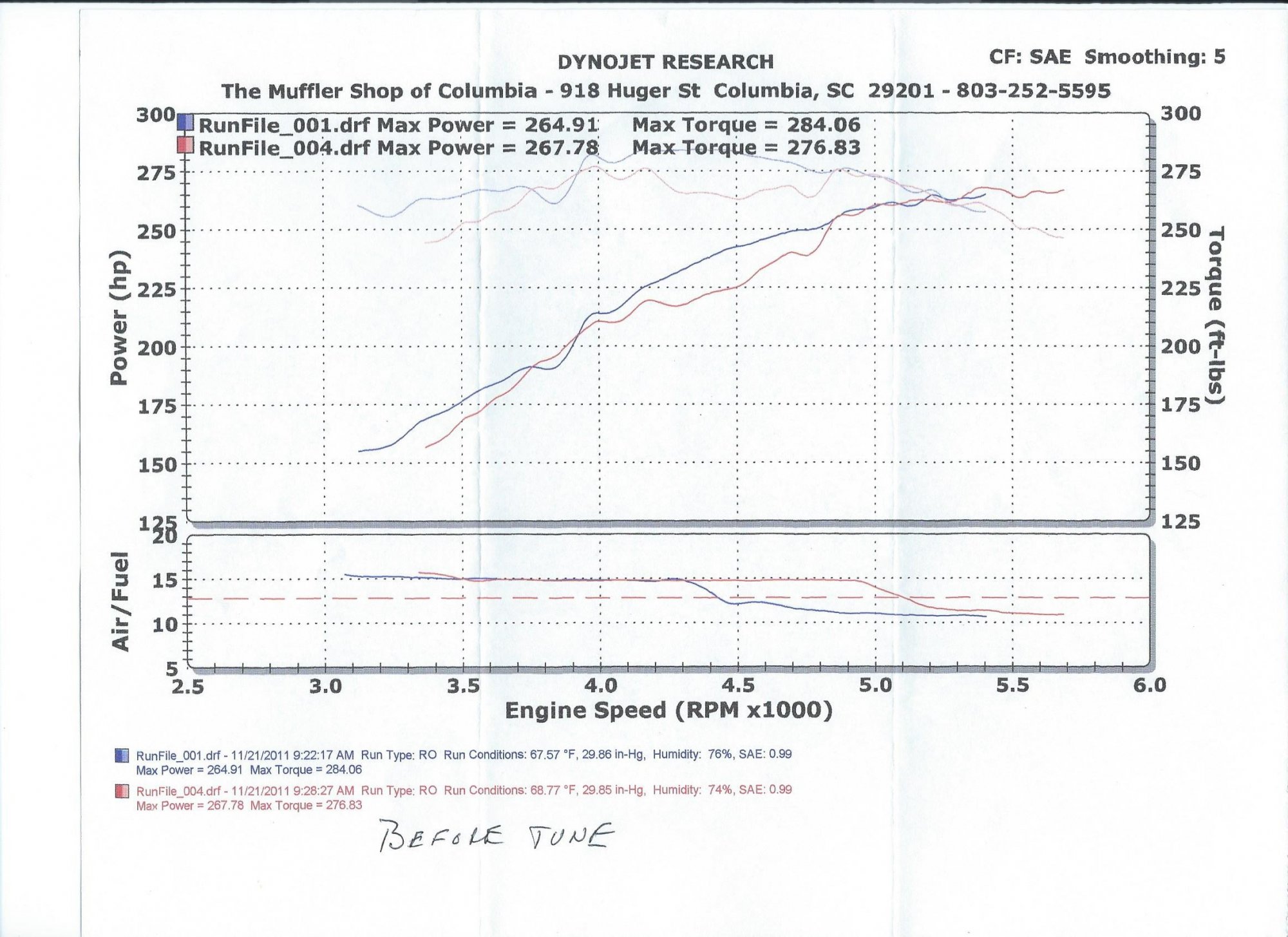

2011 5.3, 3.42.  Dynojet data before and after a Blackbear tune.  Not a huge hp/tq increase, but an increase.  Smoother, more consistent curve over stock; improved AFR.5b7ca973a554c_2011Beforetune.thumb.jpg.f957353dd9fec7e95f1a8791d9547449.jpg5b7ca9845f33e_2011Aftertune.thumb.jpg.ba581b827e8baeb10978d889d60a5451.jpg
This is power at the wheels, I presume.  If it is, this does not prove the engine is producing more (or less) HP/TQ.  It just means more (or less) of it is getting to the wheels (and that is a good thing on its own).  Transmission remapping alone can account for this, as does the expected margin of error of the test itself.  But you guys all know that, so Im all broken record right now.

even assuming this is true, who cares?  i don't know about you, but i really could care less how much power i have at the flywheel, all that matters is what is at the wheels.
as for oem vs. aftermarket, i suspect the real difference is that an aftermarket tune can take a more aggressive approach to timing and maybe afr, reduce torque management, etc.. Really just taking out some of the safety factor the OEM builds in to make sure the drivetrain holds together through the warranty period.  But that margin is yours for the taking if you want to take the chance, it is not some fairy tale.  I have no plans to tune my truck, but that doesn't mean I feel the need to disparage those who do.
