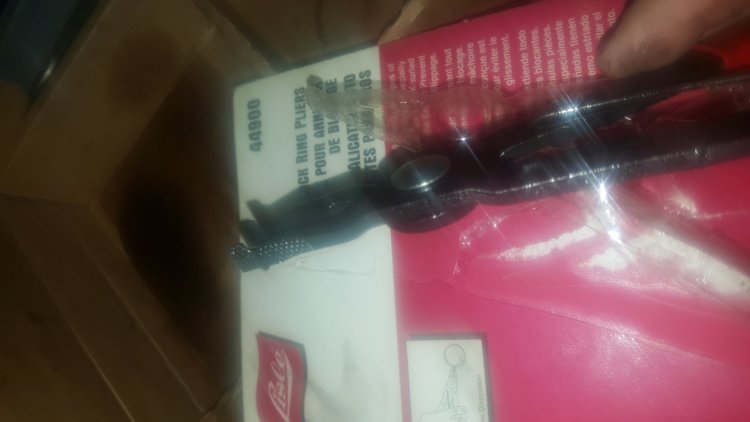

I gave up. I fabricated my own tool by grinding some flat spots on an 11 inch needlenose pliers. It came close to expanding the spring clip enough. But even with the spring clip completely disappearing into the molding of the case, it was not enough expansion to remove the bearing. It's almost like the clip was 1/16 of an inch too short. I believe if it was that much longer I could expand it enough. Although it did not complete the job, the tool I fabricated worked better than the spring clip pliers.

THIS. This is the tool I should have had all along. It's better suited for these snap rings that have no holes. This tool has flat tips that are knurled to help grab the beveled edge. Once I had this tool in hand, it only took three or four attempts and I got this bearing out. I had literally already given up and was putting the transfer case back together. Since I had large chunks together it was easy to take large chunks back out to get to this bearing and change it out. I'm very happy I didn't leave the job undone. Lesson learned. Get the right tools. I just didn't know I didn't have the right tools.
Thanks for all the help and ideas. it helped me know that I wasn't going crazy or doing something completely stupid.
