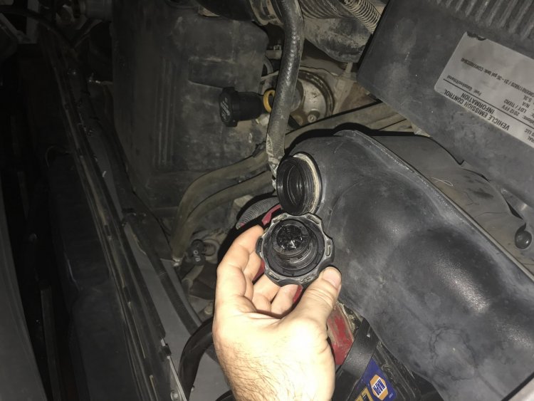

No signs of any sealant leaking , cap is clean. Pic posted below of my cap.
