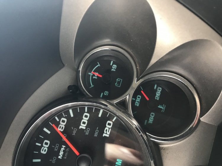

The question I have is what should my Engine temp be running on this years motor. I noticed today while on the Interstate, it was hitting the mark after 210(I believe it’s the 230 or so mark) is this bad? Keep in mind it is 98’F today and my A/C is running. Just wondering if I may need to replace my thermostat or Flush my radiator and replace with fresh coolant? Will that help or have I got bigger problems? I attached a photo of my temp gauge.

Your gauge indicates that there is a temperature issue. Possible causes:
   Internally clogged radiator
   Externally clogged radiator
   Faulty dash gauge
   Faulty temperature sensor
   Defective fan clutch / electric fan / electric fan temperature switch
   Incorrect cooling fan rotation direction (clockwise / counter clockwise)
   Low coolant
   Low oil
   VERY low or no oil pressure
   Defective thermostat
   Defective water pump
   Plugged cooling system
   Its unlikely that your fan is the issue, unless its rotating the wrong way. (fans are not needed at highway speeds)
Assuming your water and oil levels are correct, I would start here to verify that you have an actual temperature problem:
https://www.amazon.com/TOP-MAX-Thermometer-Temperature-Measurement-50-360°C/dp/B01N5FMX0G/ref=sr_1_1?ie=UTF8&qid=1527543736&sr=8-1&keywords=thermal+gun
Yeah, that is running hotter than normal.  Above post is good advice.

I will definitely try this. It really odd also cause, when I pull off the highway or interstate it will almost immediately start going down once I park. As in the gauge will start to immediately drop as if the fans start to cool it down. Then once I hit the road again back up? Would this still be one of the above issues?
Normally, people overheat at lower speeds, not high speeds. Aside from a few obscure things, I listed all of the probable causes. If your vehicle overheats at highway speeds rather than city speeds, then I would expect that you have a cooling system efficiency problem. Normally you overheat due to low coolant. Next cause is insufficient air flow through the radiator. If have full coolant, and are overheating at highway speeds, then you have eliminated most of the normal issues. Efficiency problem means that you have a coolant flow blockage, or an air flow blockage. Maybe a problem with your water pump, thermostat, clogged radiator, piece of cardboard stick to your grill. Your cooling system is working too hard. Something is gumming up the works.

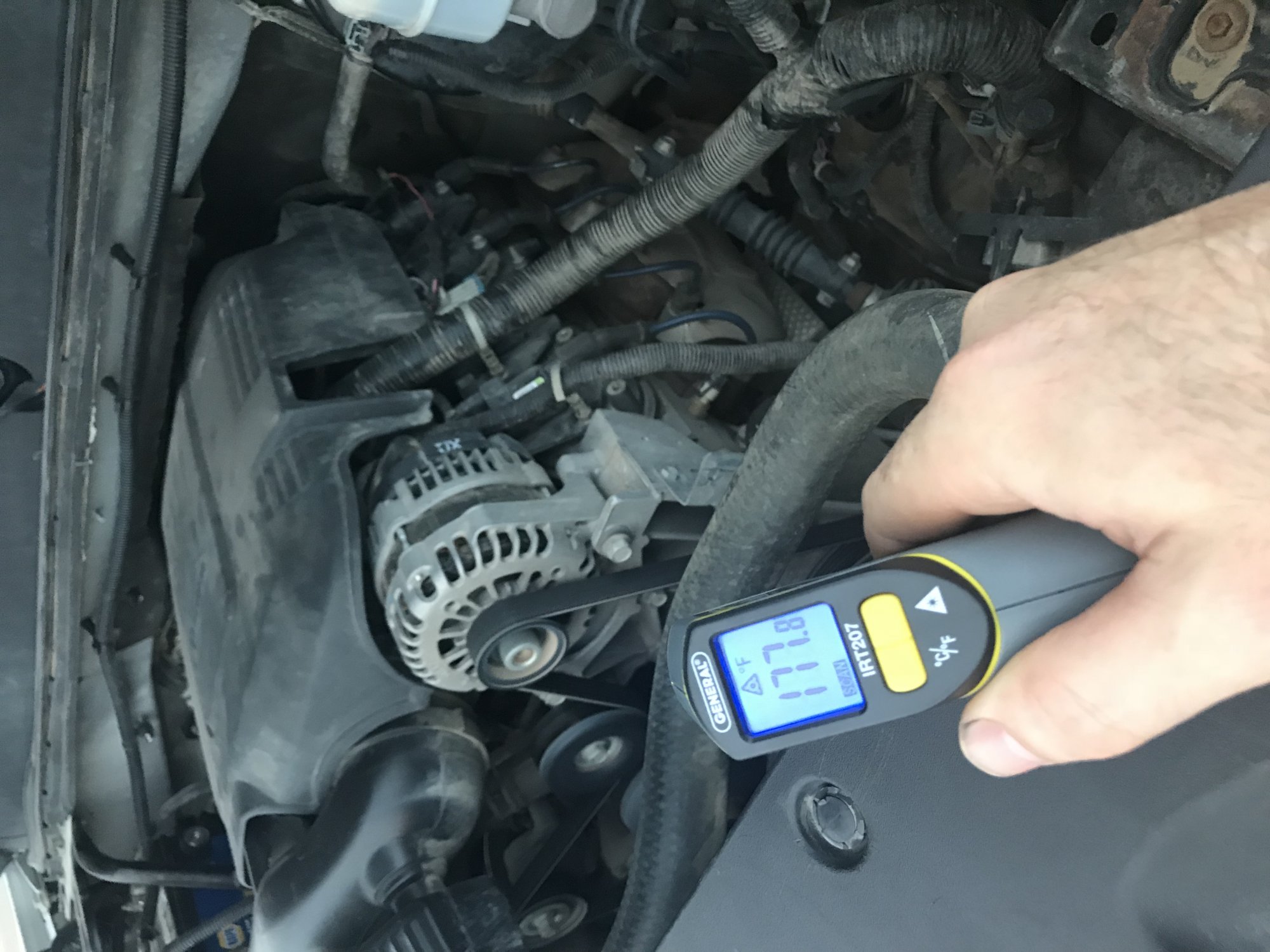

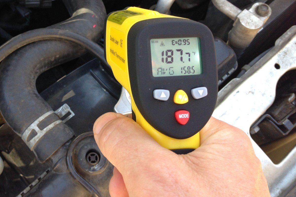

I have a code reader and nothing shows up on it. The only code that has ever shown up was an oil pressure sending unit and I replaced that. I went and bought a temp gun and took some readings my gauge is currently sitting on 210 and the readings from the radiator to the thermostat to the inlet of the water pump all show below that. I will attach pictures. Like I said this is temp in town I will check on the highway tomorrow, but I wondering if my gauge or the temp sensor may be messed up?
