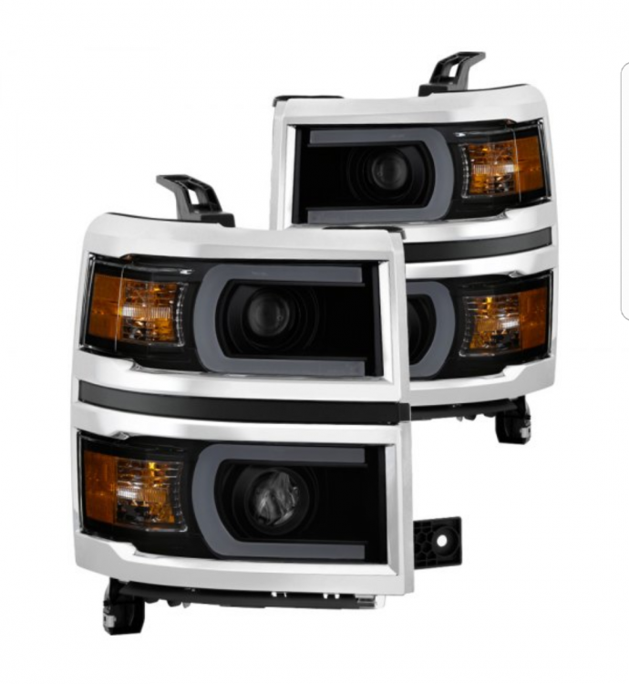

  I got a set of Spyder DRL projector headlights and bought a set of amber LED turn signal bulbs. It wasn't until I installed the turn signal bulbs that it started hyper flashing and displaying error message "turn signal failure"

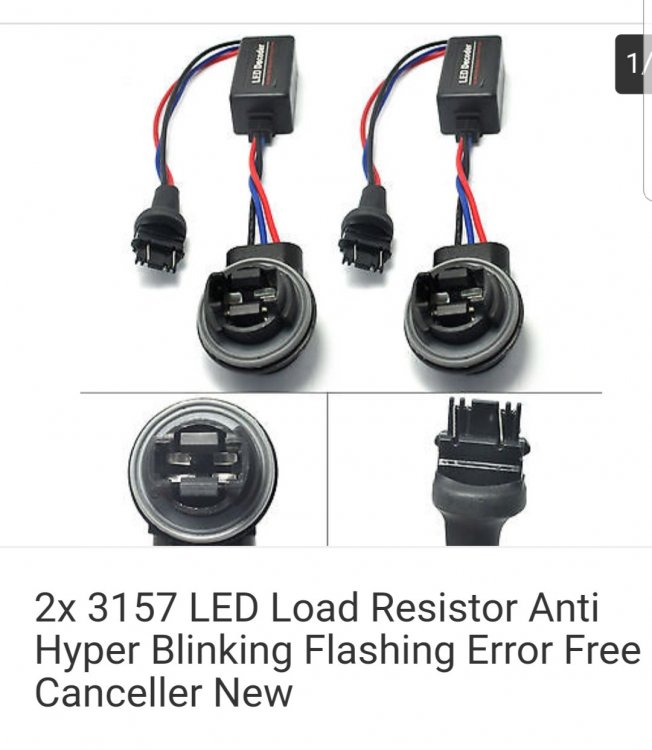

  I've learned about how LEDs register lower ohms so the truck thinks there are no bulbs, makes sense. The ECM runs the signal relay so there is nothing there to replace. So I bought 4 LED load resistors specifically for the hyper flashing and error message. "See Pics" The resistors were not plug and play on the socket side so I used the sockets that were on the lights and wired 2 of them inline on the passenger side. One for each bulb. Bulbs work but, still have hyper flashing and error message. To test, I fully engaged the signal handle, I didn't use the hazards.

The only thing I can think is I've got a bad set of No Name resistors..
Yeah - The error message won’t until until 3 blinks. Then you’ll get the message. The DIC should tell you if it’s front/rear, right/left for the failure.
The Spyder tails should have build in resistors. Check your DIC and see where the issue is being reported. Those error cancelling resistors don’t show specs so it’s hard to say... but I’ve never had luck with those.
I also learned that hose plug in style connectors and insert either way. So check to make sure if the same issue is exhibited when plugged in flipped.
