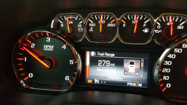

Phil, I installed the old light and found that the battery gauge still drops down to 11 but it doesn't affect the blinker. Does a gauge dropping down like that mean that I have a bad battery?
43 minutes ago, 2017_whitez71 said:
The DIC is Driver Information Center. It is the small screen between the tach and speedo.  For what it's worth I had a set of aftermarket lights similar to yours.  Also had problems with hyper flash.  Got rid of them and installed factory led taillights with adaptor harness and have no problem for over a year.  Best of luck!
 Thank you for the info.  mine only hyper flashes when the battery voltage drops down. Other than that it works fine so I'm wondering if I have an electrical issue as the battery still drops down and then comes backup to 14 after a while.  Or maybe it's the battery.
Sounds like an electrical issue. With the factory light installed, does it hyper flash at all?
If no, then you might have 2 issues - faulty tail light and an electrical issue/battery.
 With the factory tail light in it does not hyper Flash at all. But I have tried 4 different LED tail lights and they all have the same issue. So that makes me think it's only an electrical problem or battery itself. Each of the LED tail lights were brand new
