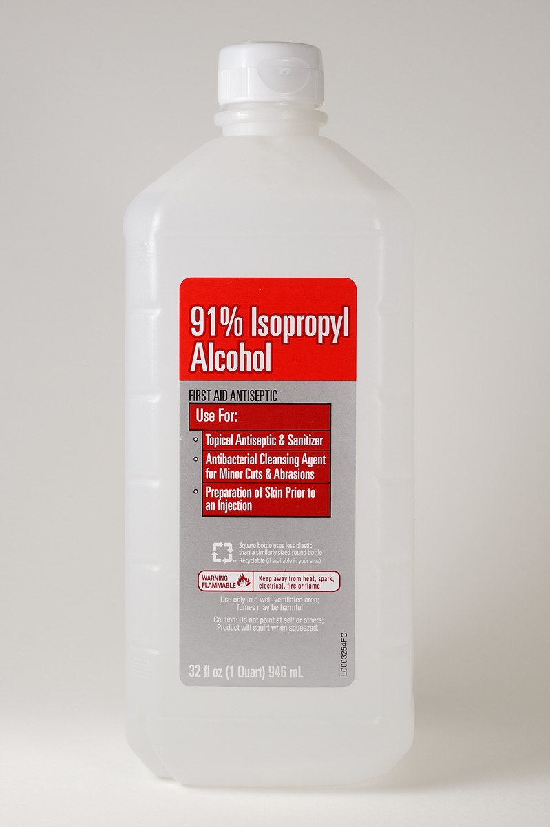

Here is what I would (and have) done:
Thoroughly clean the fittings with alcohol. Coat the fittings and 1" either direction with this sealer. Let dry for 24 hours before pressurizing the lines. I have used the same procedure to re-attach radiator hose fittings to a radiator, patch oil pans, fix broken fuel tanks on chain saws, slashed sidewalls on offroad tires, etc. Its not pretty, but it works. Its liquid rubber in a can, and it sticks extremely well to clean surfaces.
