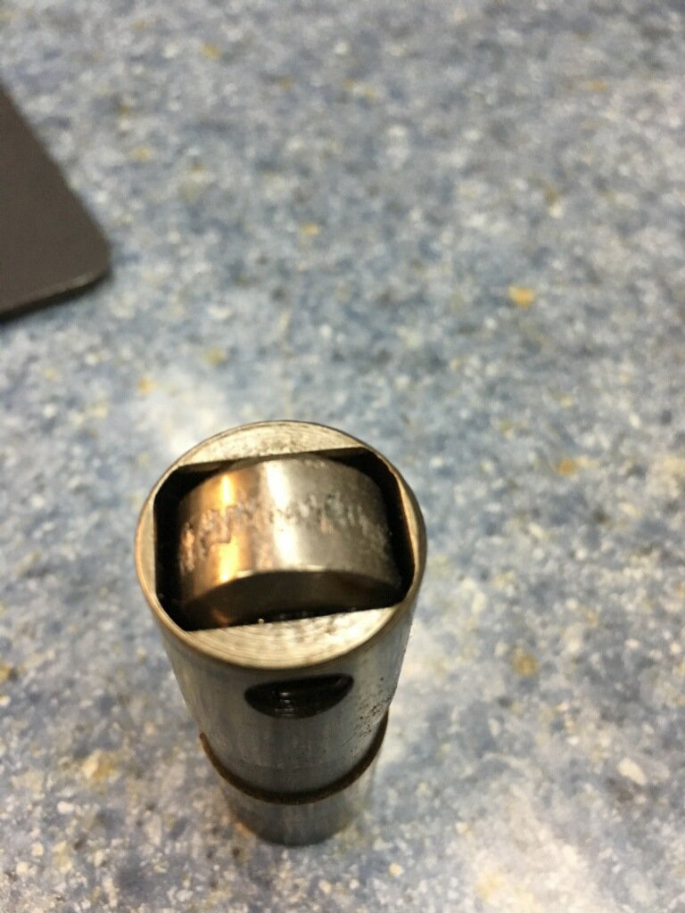

Well, I gave up and dropped the truck off at a GM certified shop near me. After a couple of days messing with it he called and said he was pretty sure it was a lifter so I told him to go ahead and dig in. He found the exhaust lifter on #5 to have a roller that was kind of chewed up and the cam was damaged as well. I attached a pic of the lifter, I hope it's visible. It's frustrating because No. 5 not even an AFM cylinder. He said the plastic lifter tray wasn't cracked and it didn't appear the lifter had rotated, not sure why it did what it did. However I'm not the original owner, it was a trade in vehicle at a Ford dealership when I purchased it back in November. It may have had repairs prior to me buying it that were done poorly just to make it run to trade it in.
So of course that meant new cam and all new lifters. I made sure he got the newest updated GM lifters, replace the plastic lifter trays,  and had him change the VLOM to the newer updated version. Knowing he was going to have the timing chain cover off and would be looking at the oil pump, I had him replace that too.
The truck now idles quietly and smoothly, no misfires, and has the throttle response of a new truck.
On a side note, a week prior to the repair I put new y-pipe/cats on the truck, bought it online from AB Catalytic, exact bolt up replacement. Since I got the truck back it threw a P430 code, poor cat performance bank 2. The cats are literally 3 week old and only ran a limited amount on the engine with the bad lifter before the repair. I know the cats are good. I don't want to continue on that topic on this thread, I'm going to start a new one on just that subject. Just wanted to say thanks to all who shared their thoughts, and post the solution to the P0305 misfire in hopes it helps someone who finds this discussion later.
Happy to hear you got it sorted out.  Have to wonder if the valve train noise was being interpreted as pinging and the ECM was backing off timing as a result. That roller looks like the early beginnings of the Honda V4 bike engine camshaft issues in 82/83.
