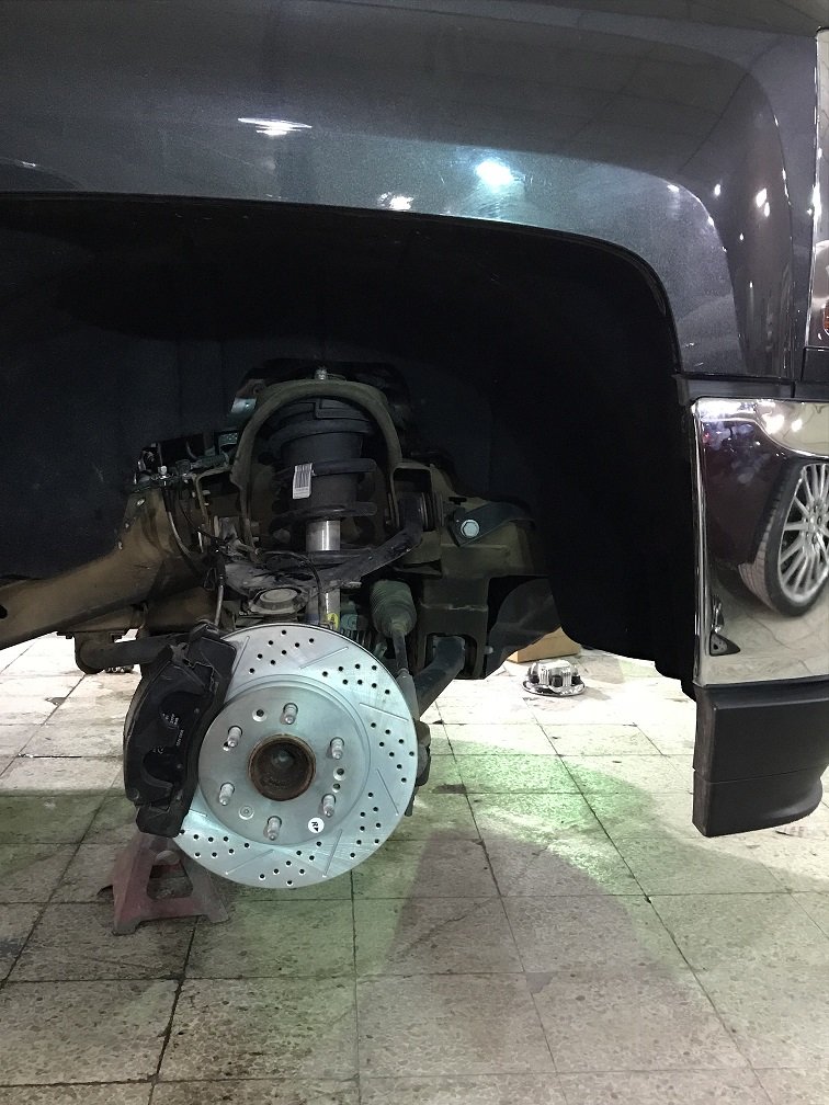

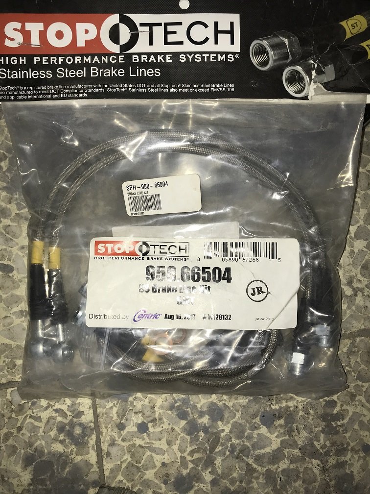

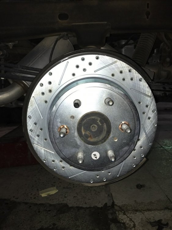

I had the chance to install the Baer sport rotors, Baer sport brake pads and the StopTech Stainless Steel braided brake lines on my 2016 Chevy Silverado 1500 2 days ago. I have truly enjoyed the brake performance especially when compared to the original stock brakes. The consistent pedal feel, brake pedal modulation and  brake power are truly worth the investment.  I would advise any GMC Sierra or Chevrolet Silverado owner who wants or needs better braking for their truck to pull the trigger on upgrading their brakes. A list of the part with part numbers and photos are below.
Baer Sport Front Rotors (Pair)                          P.N. 55097-020
Baer Sport Rear Rotors  (Pair)                          P.N. 55133-020
Baer Sport Front Brake Pads                             P.N. D1363
Baer Sport Rear Brake Pads                              P.N. D1707
StopTech Front Stainless Steel Brake Lines   P.N. 950.66002
StopTech Rear Stainless Steel Brake Lines    P.N. 950.66504
Note: I would suggest that you upgrade your brake fluid to a D.O.T 4 spec fluid at the same time.

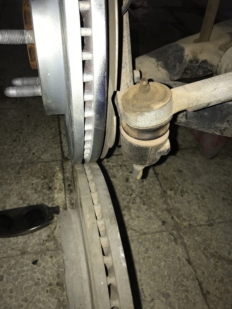

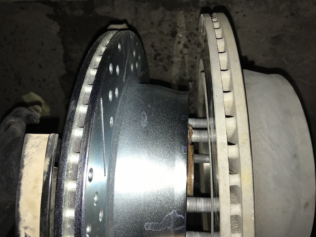

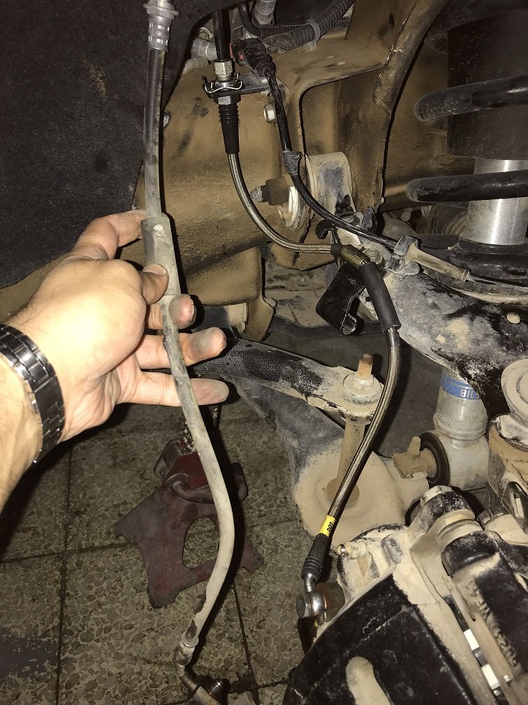

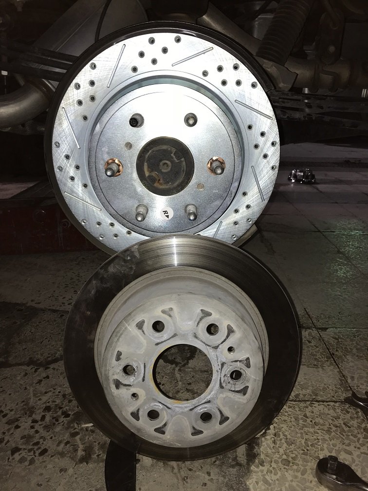

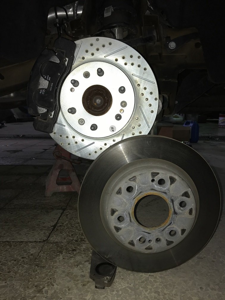

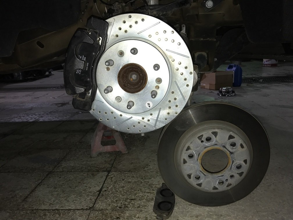

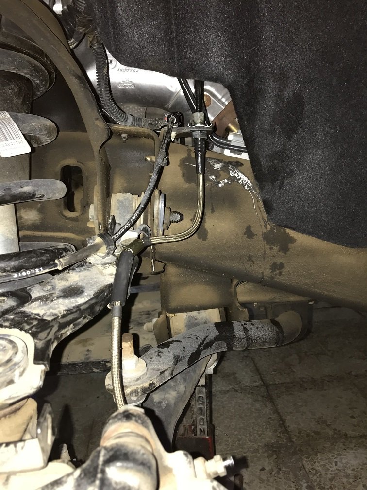

Front Rotor, Pads & Brake lines installed   Front Baer Sport Rotor vs Stock Rotor5b5916d5c13e2_Silverado7.thumb.jpg.fa0f68e1ff423e5b7ca28fa04cfed838.jpg5b5916dbd474b_Silverado10.thumb.jpg.73003ef24bf03ebc08c8b72a1defe98a.jpgBaer Sport Rear Rotor vs Stock Rear Rotor5b5916e253bf4_Silverado13.thumb.jpg.92f22d4dbe2325106089c8e6fc8b3eb6.jpgStock vs StopTech Front Brake Line

Thanks for posting this. I have done this mod on other GM vehicles with positive results and been wondering as the factory GM set up on the new trucks is noting like it was on the older trucks. Did you install the rear lines too? Any issue with bleeding the ABS unit? use a Mityvac?( I got 120k mi out of my' 04' 1500 and could have gotten another 20k, and less than 30k from my 15' 6.2 brakes(warranty replacement))
Is the overall power/stopping distance that much different or just a much better feel?

The overall brake power & stopping distance has been very noticeable. Much better brake consistency with a greater pedal feel.
How about brake dust?
Some report an increase in dust with drilled and slotted rotors.
Then again maybe it depends on brake pad composition....

I can not reply to this question until i get some mileage on the truck with the new brake setup in order to give you a true answer.

Sierra Dan,
After having the brake upgrade and using the truck for approximately 500 miles, i have had no brake squeal or excessive brake dust. Matter of fact the brake dust is slightly less than with the stock brake pads.  The braking performance is worth the investment.
I hope that gives you a good description.
