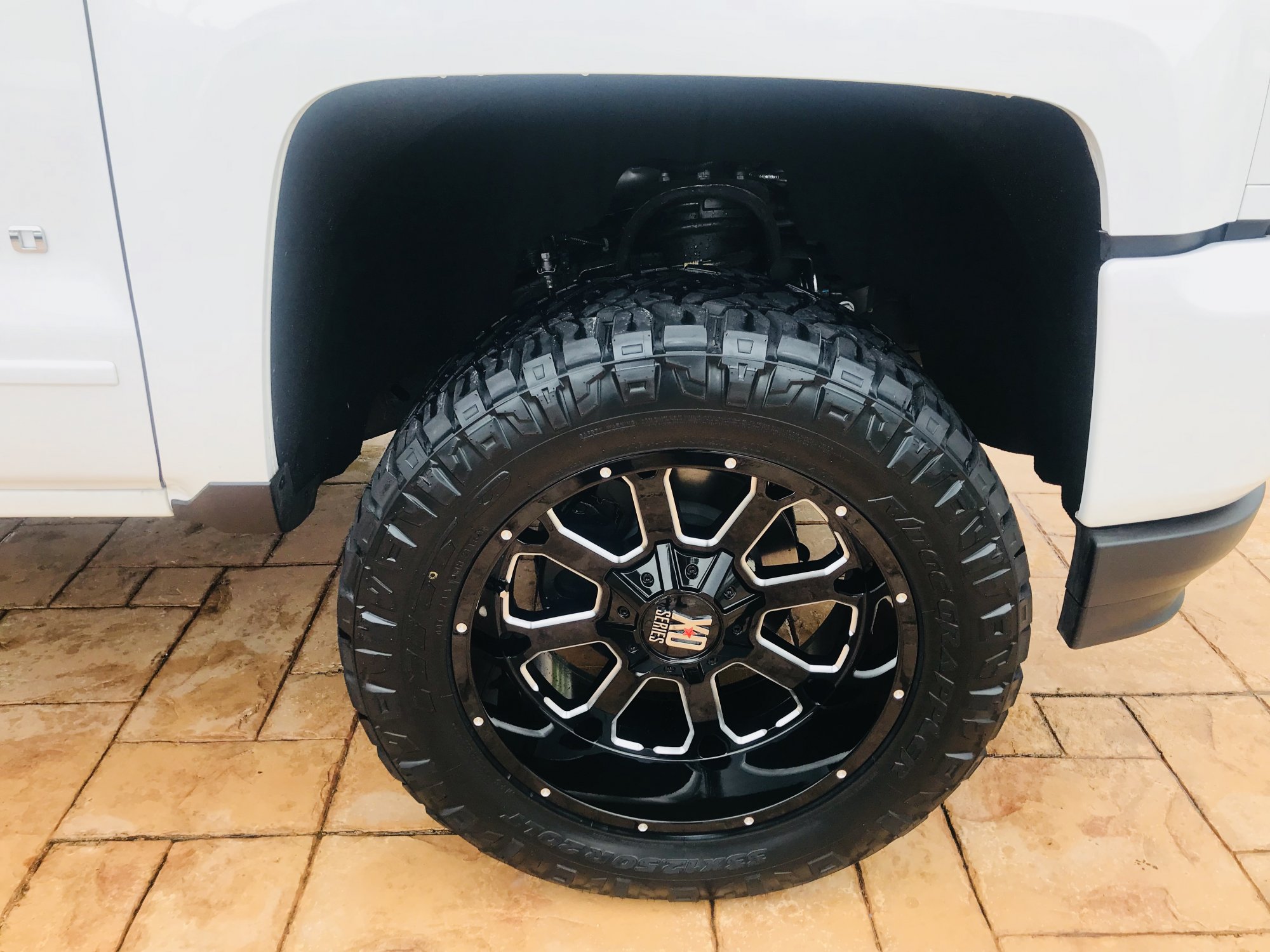

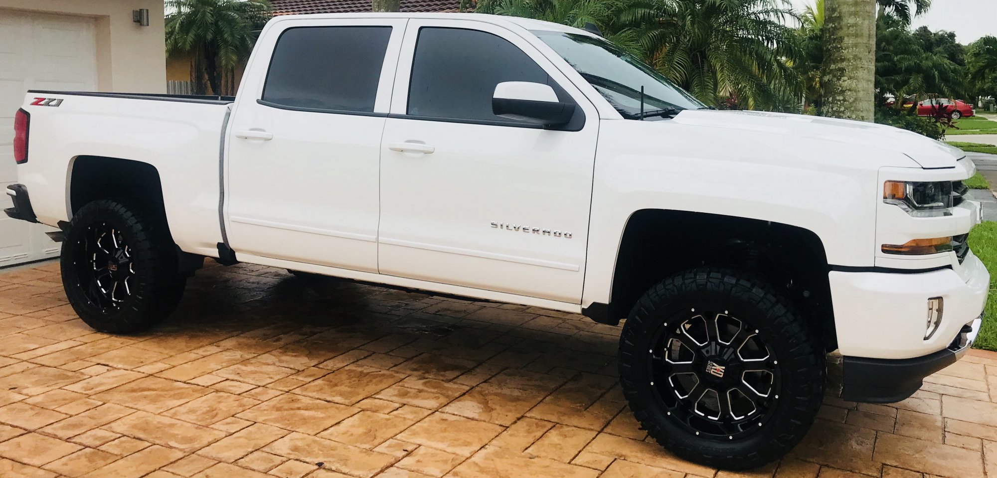

Hello everyone, im creating this post because there was little information about this lift kit when i was looking around. I have a 2018 Chevy Silverado 1500 Z71 and i wanted to lift it , but i didnt want to go that high. I eneded up deciding to go with the Rough Country 3.5 in Knuckle Lift kit with the N2.0 Front Shocks SKU :12132. The kit is around 600$ and its a 5-6 hour installation time. I know some guys dont like RC , and the other chevy kits didnt have many happy customers. This kit was relatively new and it came with knuckles which is suppose to fix the suspension angles that a level kit would ruin , and it did. I had a 2.5 Moto Fab level kit and the truck ran really hard and i didnt like the ball joint angles. Well I can say that im happy i went with this kit . The truck rides really good and looks great. I was able to fit Nitto RidgeGrapples 33x12.50 and XD series Buck 25 20x10 wheels. It rubs a little at full crank at the lower rear plastic trim. I’ll post pictures so you guys can see. If anyone has any questions feel free to ask i’ll answer them as soon as i can , i hope this post helps anyone decide what route to go with when deciding a lift kit.

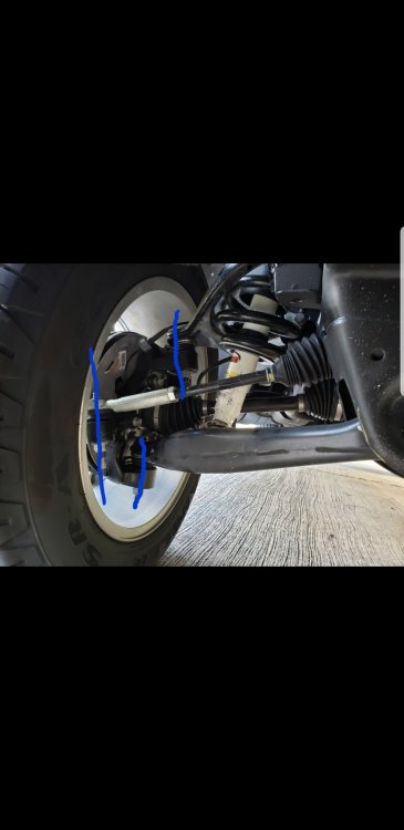

angles are too high, rough country is notorious for bad angles on their lifts that knuckle doesnt look taller either its just modified to save balljoints from the terrible angles... good lord RC what next..

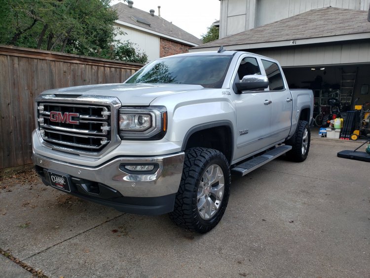

Your also running offset wheels so that eont help either lol Top is before, bottom is after
So you went with a RC 5 inch lift after you were running into problems with the 3.5? The truck looks sexy as F**K by the way

the CVs will have premature wear, your balljoints upper lower and outer tie rod ends look to be in better placement so you might be ok there, just depends on your driving style.
I cant tell you how many ball joints and CV shafts ive destroyed and I have good angles on my  7" haha
