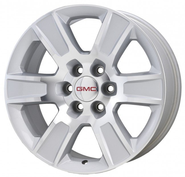

So I have to buy to tires for the upcoming winter. I was wondering if I would be able to fit 295/60/20 on the rims I attached to this thread. (20x9, 27mm offset, 6.06 backspace) Before I bought this truck, I only had cars which I lowered and widened. Very much new to having a truck. Please forgive my ignorance. I plan on getting a leveling kit for next spring but need new tires sooner.
Thank you.
That will rub.   Stock height you can do 275 60 20.  I'm not sure what else without rubbing
I have been running 305-50-20 Michelin defender ltx with no rubbing,stock height. 12.4 section width,32 inches tall. The specs for stock size Michelin 275-55-20  is 11.2 section width,31.9 inches tall. Also running stock wheels.
295/60/20 will rub at stock height regardless of what rim they are on.    A 2.5 inch level should clear without too much rubbing provided that you don't do heavy offroading and use an All Terrain/Highway type tread.  Mud Terrains will rub badly.
