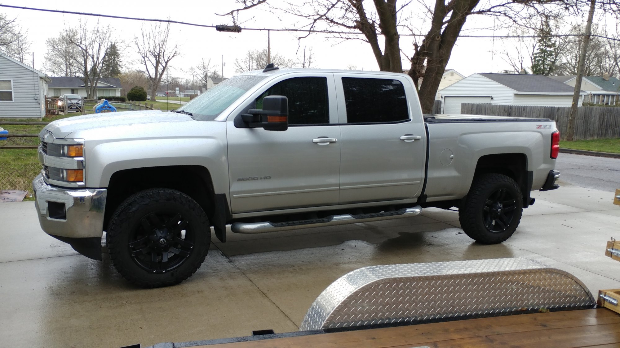

Here is my 15 with the stock keys turned in 5 turns. About 1" of lift.
IT rides and drives good. CV angles are good.
Tires are 275/65 R20. 34.1x10.8. They don't rub.
Front shocks are starting to leak after 41k miles. So I am looking to do a proper level kit.
I had the rear lowered at one time and loved the look. But missed the height.
And I wanted to add air bags to the rear so I had to go back to stock.

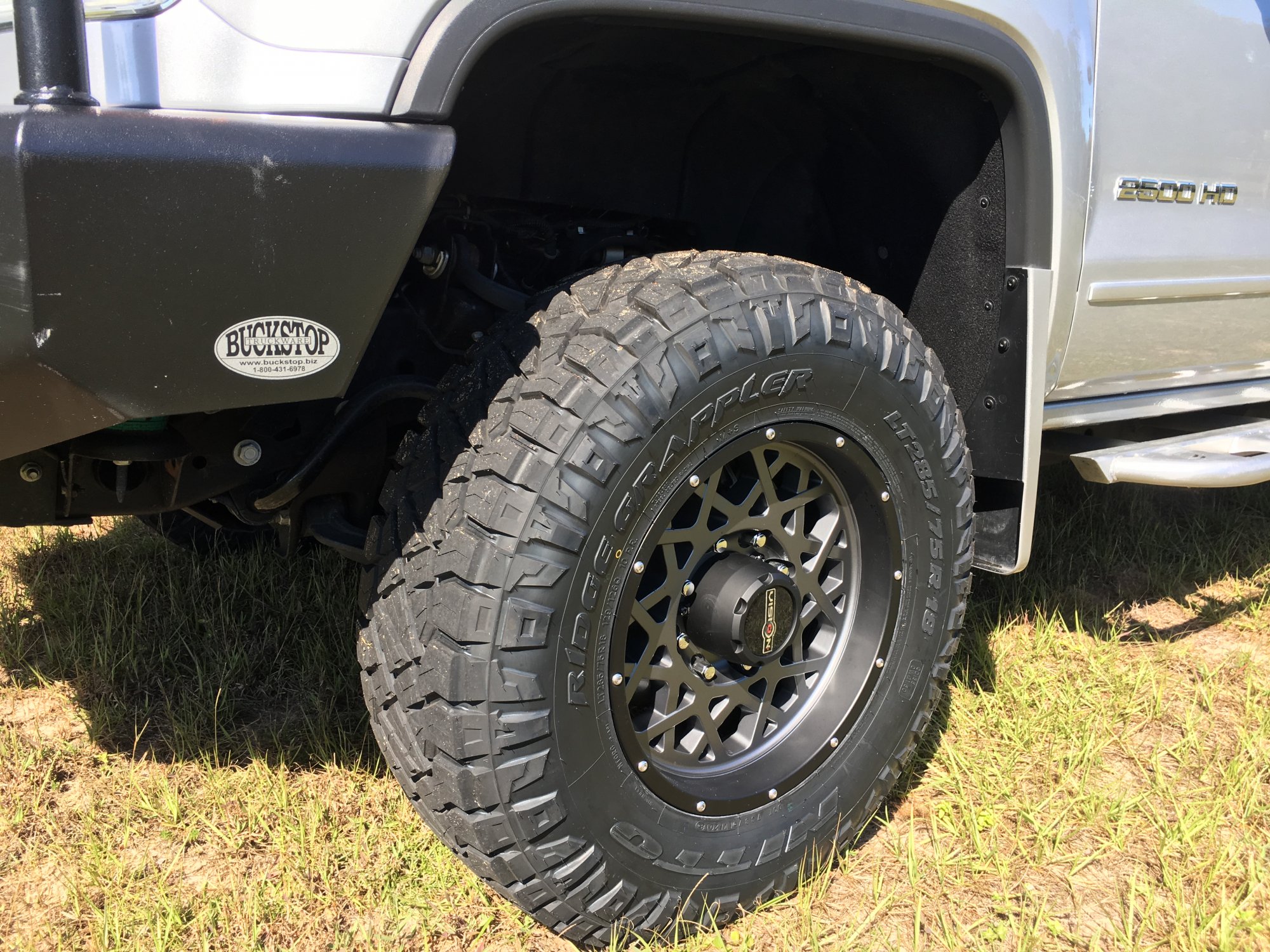

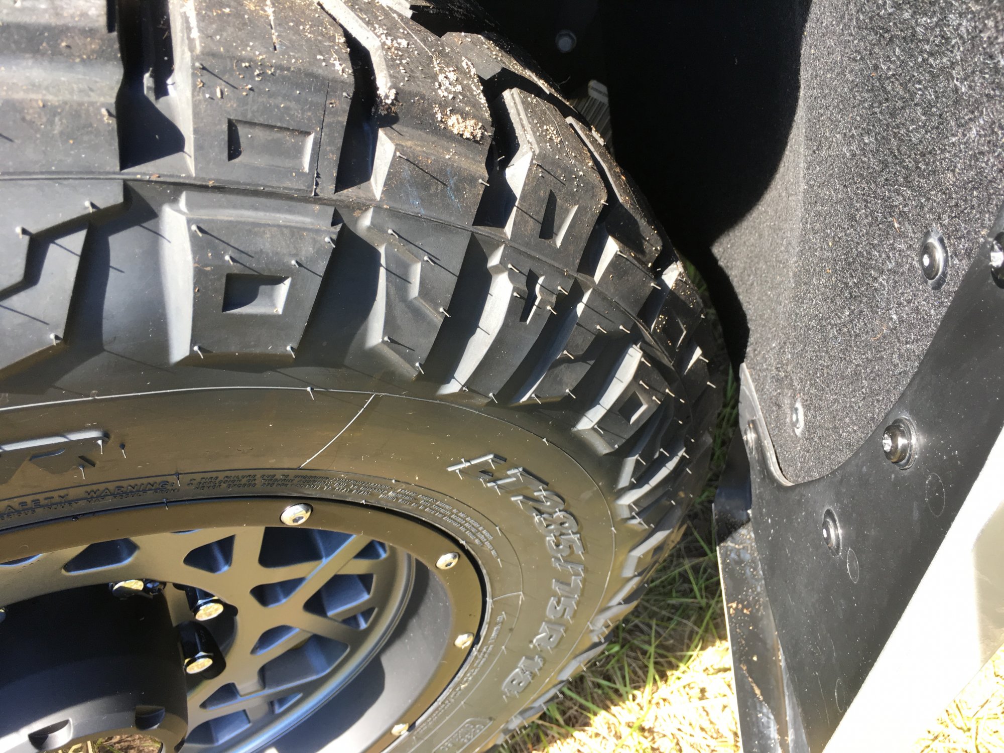

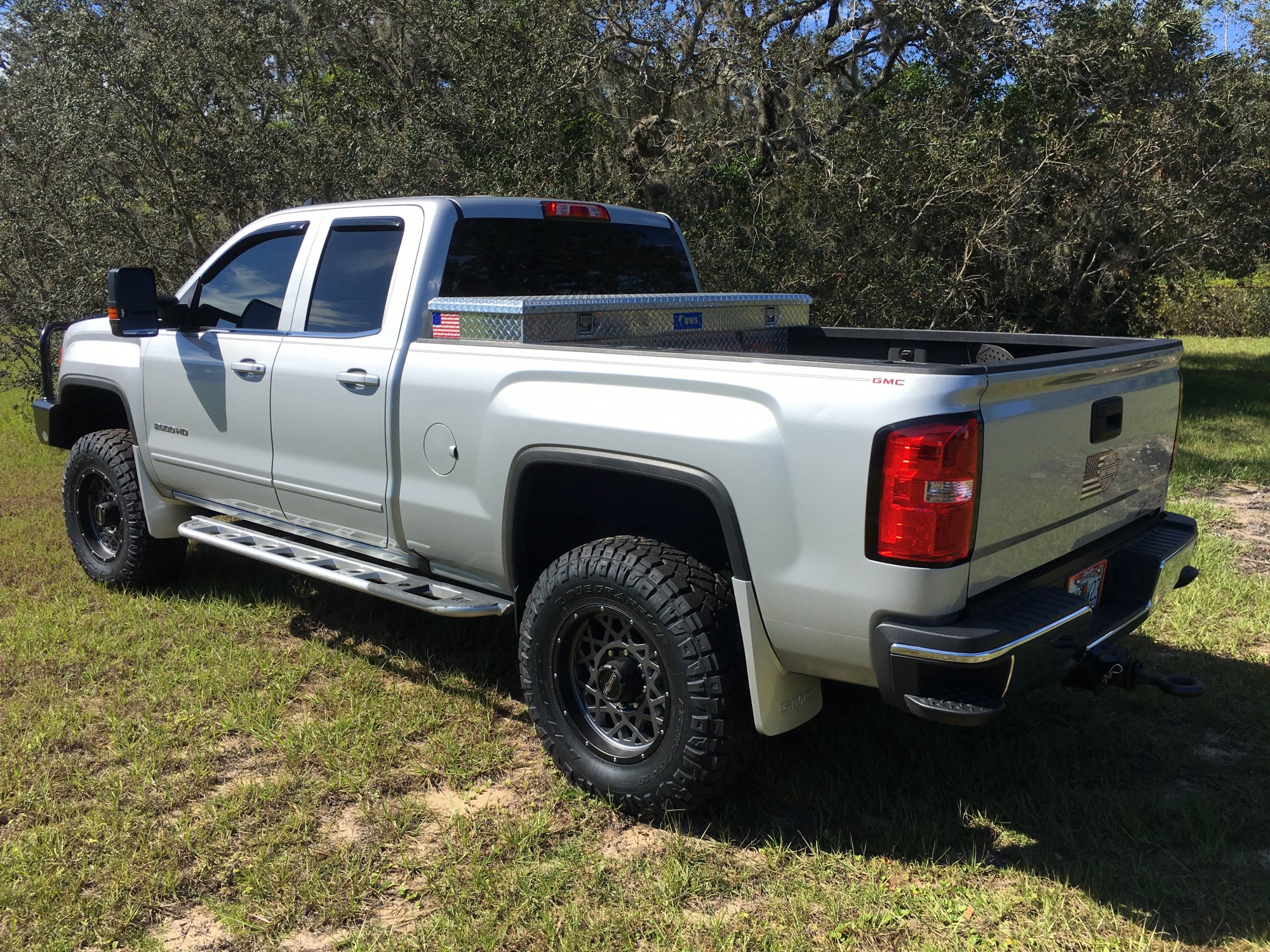

3DECF003-E634-4A1B-BDED-3EF2F4E9EBE7.jpeg.cbcc91e3ae7625ad684f823bf38f1281.jpegfirst pic is stock
second is torsion bars maxed out
third is the Zone adventure series 3” adjusted     to 27 1/2” from fender to center of hub.
285 75r18 on 18x9 wheels with a + 12 offset. Had to put in aftermarket keys, as the stockers didn't raise it enough to clear the inside of the fender at full lock.
Hasn't rubbed on the street yet... keep turning down the adjuster bolts for a better ride. Almost no rake, like a 1/2 inch higher in the back, I prefer a little rake, so I have a 1 inch block kit and a diff drop coming in the mail.
