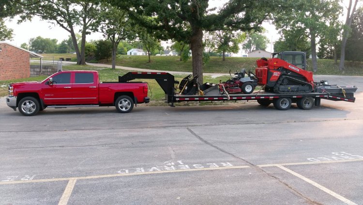

Turned up factory keys, shock spacers, air bags in the rear, 305-70-18 coopers on factory wheels. 7c771e76807a76a5b2c2729c2f2dee99.jpg74af8e343638b599925150196741b909.jpg8511b6623f7ba8e354274d356d2dcabc.jpgfe95172215ef909ad455115e3fbc3d22.jpgfa9f09f37f72d9678348dfff66157875.jpg

Any photos of it not towing?
only one I've got lol
And this is just rear lowered 2”? Nothing done up front?

How do you like it with the stock keys cranked? How high did you end up going roughly?
It's great, it rides better than stock, because it's off the lower bump stops on the lower A arm.
It's about 1 3/4"-2" raise. I made sure to keep good space between the upper A arm and the stop for it (it's straight metal) so the ride isn't affected. Make sure to add shock extensions though, I made the mistake at first of not doing that, and I had clunking in certain situations, annoying more than anything.

Any rubbing with those 305's?
A little bit on the frame at full lock
