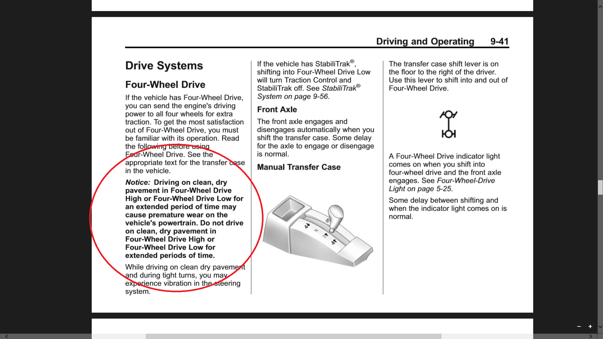

On hard surfaces they will bind, unless it's the awd version.
The outside wheel has to travel farther in a turn than the inside wheel. If it's fully locked it can't do that without something slipping. Be it the tires slipping on the ground or something slipping in your transfer case.
Ive had the truck since new (4 years) and it's never done this before. Its not an AWD.
What would be the point of a 4x4 mode that can only be used in a straight line or gentle bends? Sorry I might be dumb as it doesn't make sense to me.
 Thanks.
If you've owned it 4 years then by now you should know it is a normal function of a 4x4 vehicle when tires are driven on surfaces with almost normal grip levels. All 4wd vehicles have binding when you are near the full lock point when turning. My 2001 Silverado did this, my 2010 Sierra All Terrain did it, my 2014 Sierra All Terrain did it as does my 2016 Sierra All Terrain.
You wont notice it on grass, mud, offroad or snow/ice as the front wheel are slipping enough to not be noticed. Get the front tires on pavement that is only wet and you will notice it if you are fully locked in 4wd Hi. If you are in Auto you may not notice it as once the system doesnt see tire slippage and the decay period has expired the system releases the transfer case clutches to go back into 2wd mode.

Wow thanks guys. Ive honestly never noticed it before.
Keep driving it that way and yer gonna break something.
