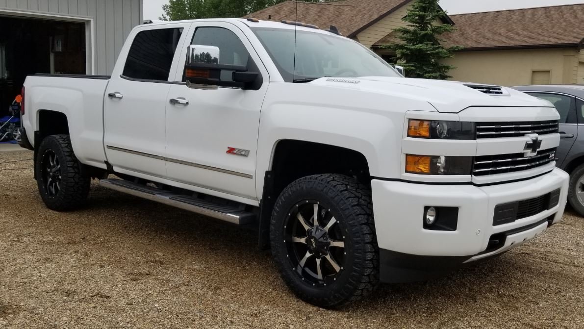

these are 20" wheels, +18 offset (stock is +44 I believe). The tires are Nitto Exo Grappler 275/60/20. Fit great. No rub in any direction, but if the tires were any larger I suspect there would be some minor rub when tires cranked. I haven't touched the stock suspension in any way.
Nice truck bro! Thanks for the tip. I been reading around and spoke to a guy at a local tire shop about sizing too. He recommended a 275 55 20 for no-rub\no-cut fit. Also said i could run a 33x12.5x20 with some cutting of plastic but i rather a more affordable/quieter/and practical tire. I has 275/65/20 on my ram stock height fit great, 34" sumitumos, good looking and quality tires i paid $550 for all 4 from eBay. I also got my steps on. Not super pleased with them but ebay seller is gonna refund me half the $ cuz one of them has a small dent, so i can live with them for now.
