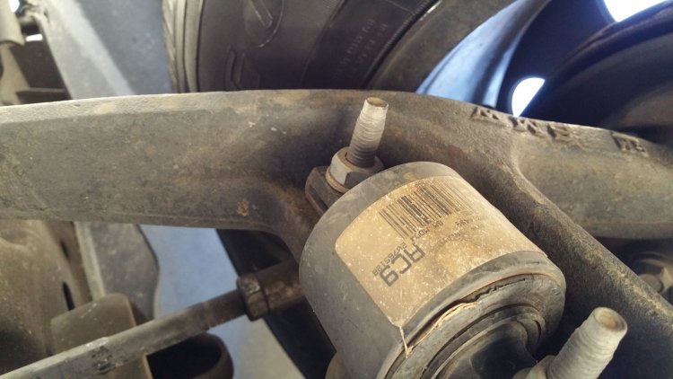

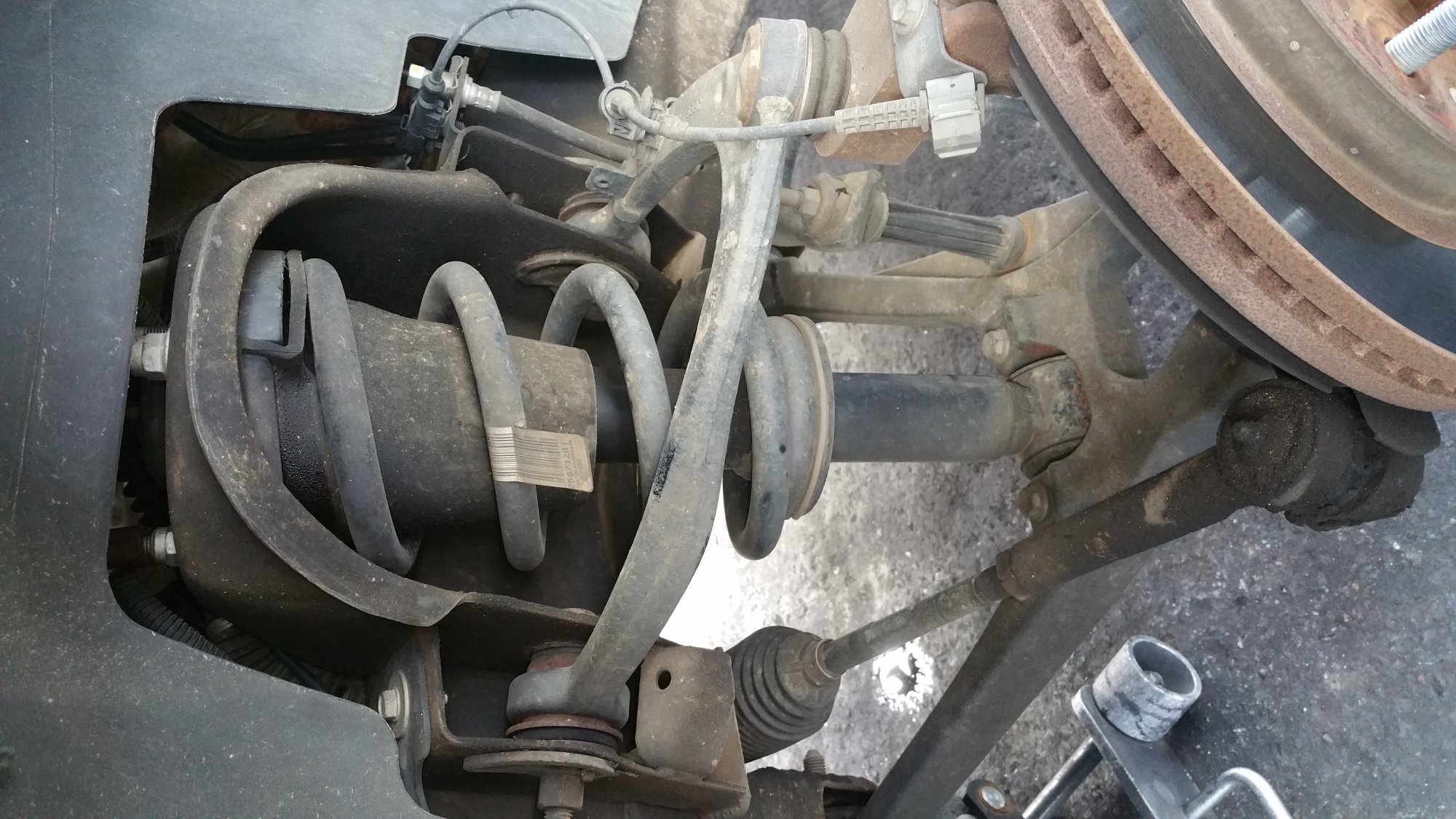

So I bought a 2009 single cab 2wd GMC sierra. I ordered lowering shackles because it has one heck of a rake. I have read online people talking how bad the rake is on the reg cabs. The other day I was under it looking and notice that it already has bell tech shackles and the 1in block is gone. It still has a heck of a rake. So this thing has to be lowered in the front but I don't see how. The springs have a GM bar code, the struts have a GM bar code. The arms look stock and the spindle don't look to be a drop spindle. I'm going to post some pics maybe someone will see something I'm missing. Thanks for the help! It's only letting me load one pic for some reason.
they mounted the shock under the lower control arm, which is a wicked shitty way to lower it.
Man I wish I noticed this! I just had the truck lined up yesterday. That Sucks!! Looks like ill fix it and like it up the old school way till I lower it right.
