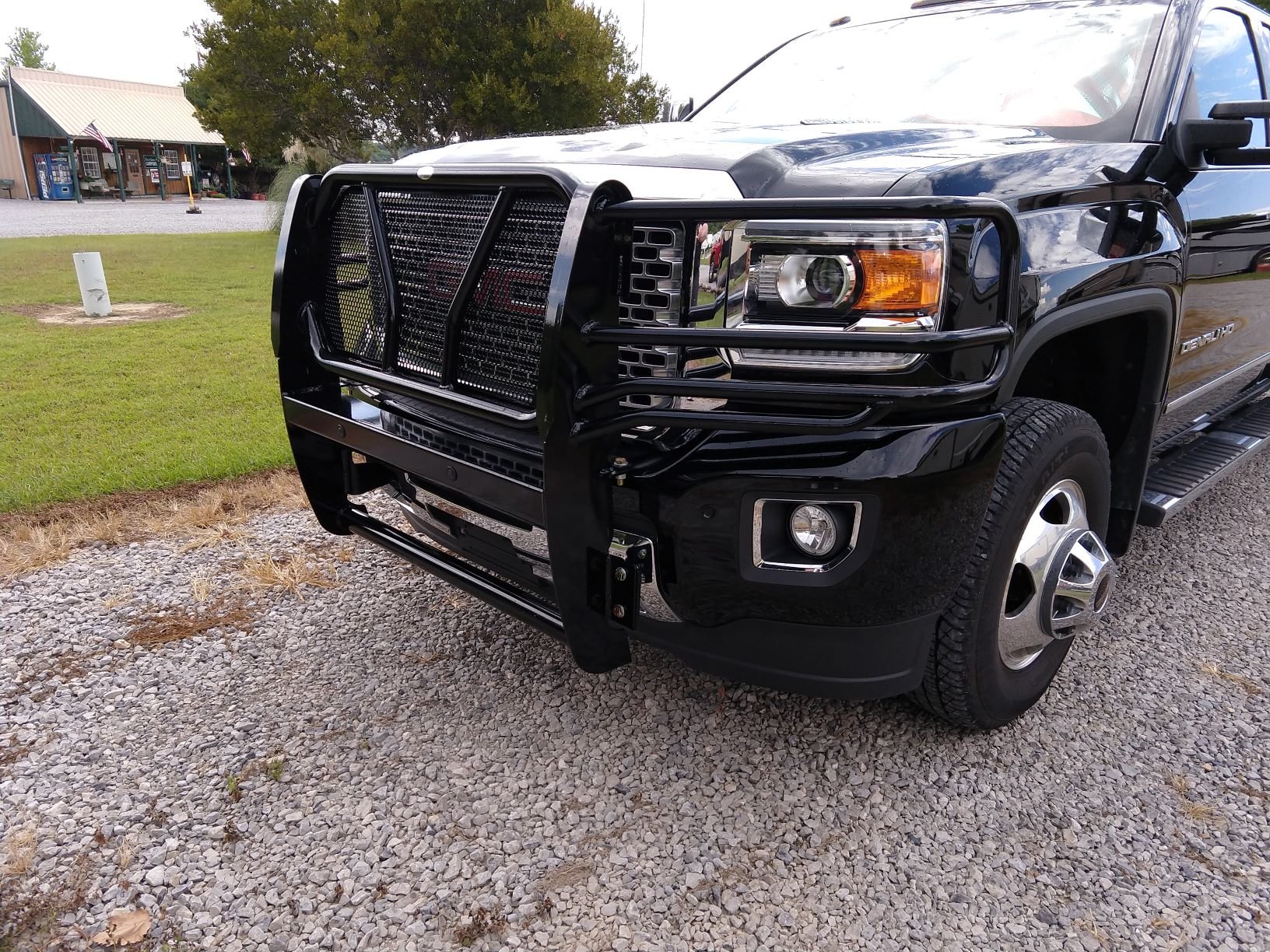

I added this grill guard, and I get spurious alarms mostly when just starting out.  Anyone else have issues with sensors?  If yes, how did you fix it?
The sensors will beep up to a certain speed and then stop. I believe you can turn them off in the vehicle settings menu.
There is a kit (albeit it very expensive) from Westin that relocates the outer park assist sensors.  It can be found on ebay for around 70 bucks
