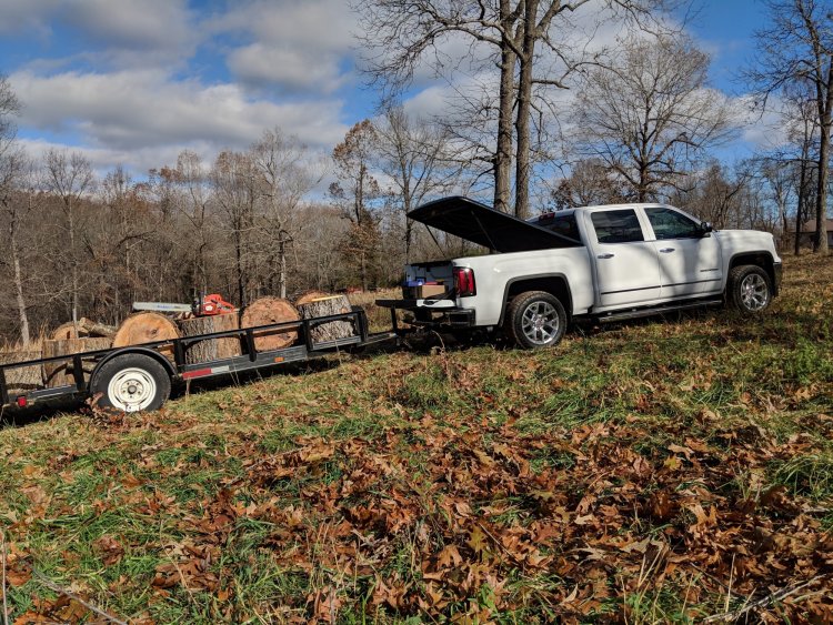

I have a 18 Sierra 6.2 8spd Denali Ultimate.
The only complaint I put forward was GMC's choice of putting 3.23 gearing the Denali line. It is the only way to get the 6.2 in 18-19 models that I have seen.
I have put 17,000 on mine pulling a travel trailer at 6,000lbs to truckloads of wet oak firewood.
The fuel milage has been good no real gear seeking except in the mountains which one would expect pulling the travel trailer.
I currently added the diablo I3 to the mix and the extra 20hp and 20 ftlbs of torque with the 93 tune are noticeable. I left the AFM in place and actually have had the truck getting better mileage after the tune. We haven't had a long trip to see the difference at this point.
My intent is to go to 3.73 gearing in the truck in the next month or so because we upgraded the travel trailer and are pulling right at the limit of the truck.
Basically overcoming the flaw GM gave the truck.
Empty on the highway we have seen mpg in the 30's to 40's with a average of 23 to 24 mpg over all.
