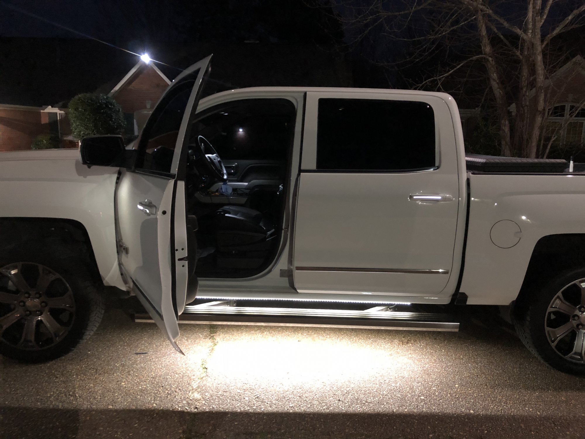

Wanting to use the mictuning led light strips as running board lights. Has anyone used these and removed the switch, or just bypassed it? I want to trigger these on with the dome light, so the switch is not needed. The kit comes with the switch pre-wired.

Yepp small gauge wire but yes I have use the on my truck and wife’s Malibu through the dome light.  Just cut out the switch will have a positive and neg
What did you mount them to and did you just use the 3m tape to secure them?
I used the 3m tape to stick them just under the rockers.  I just simply cut the wires back 2 or 3 inches from the lights and then built my own harness in when I built my harness for the tri mode steps
