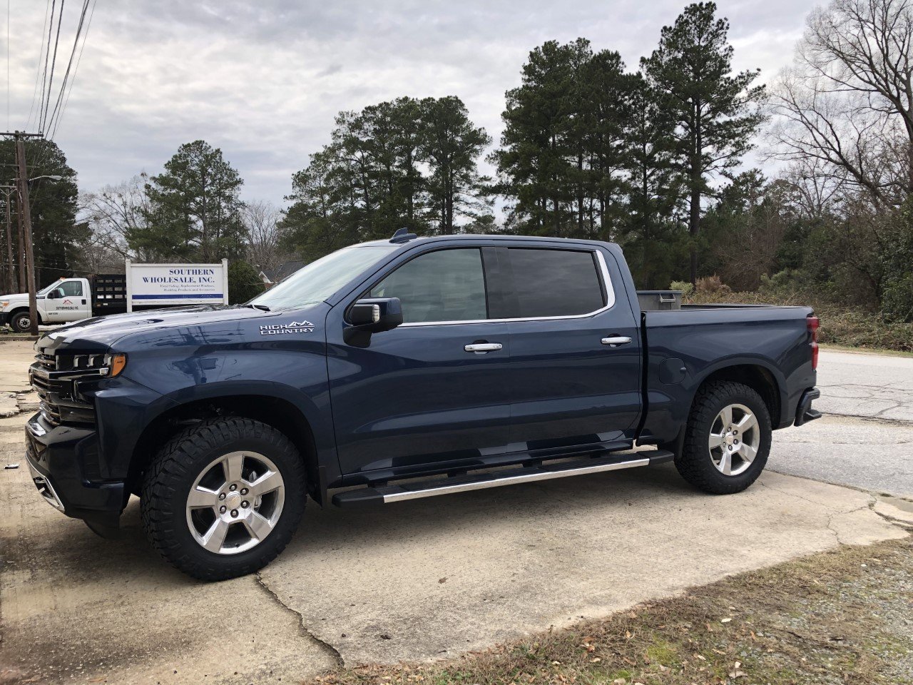

I swapped the 22"wheels that came on my truck with the 20's that where on my wifes Tahoe....the 275-65-20 did fit with just a small rub but I still have to get it leveled. Turned out pretty good.
