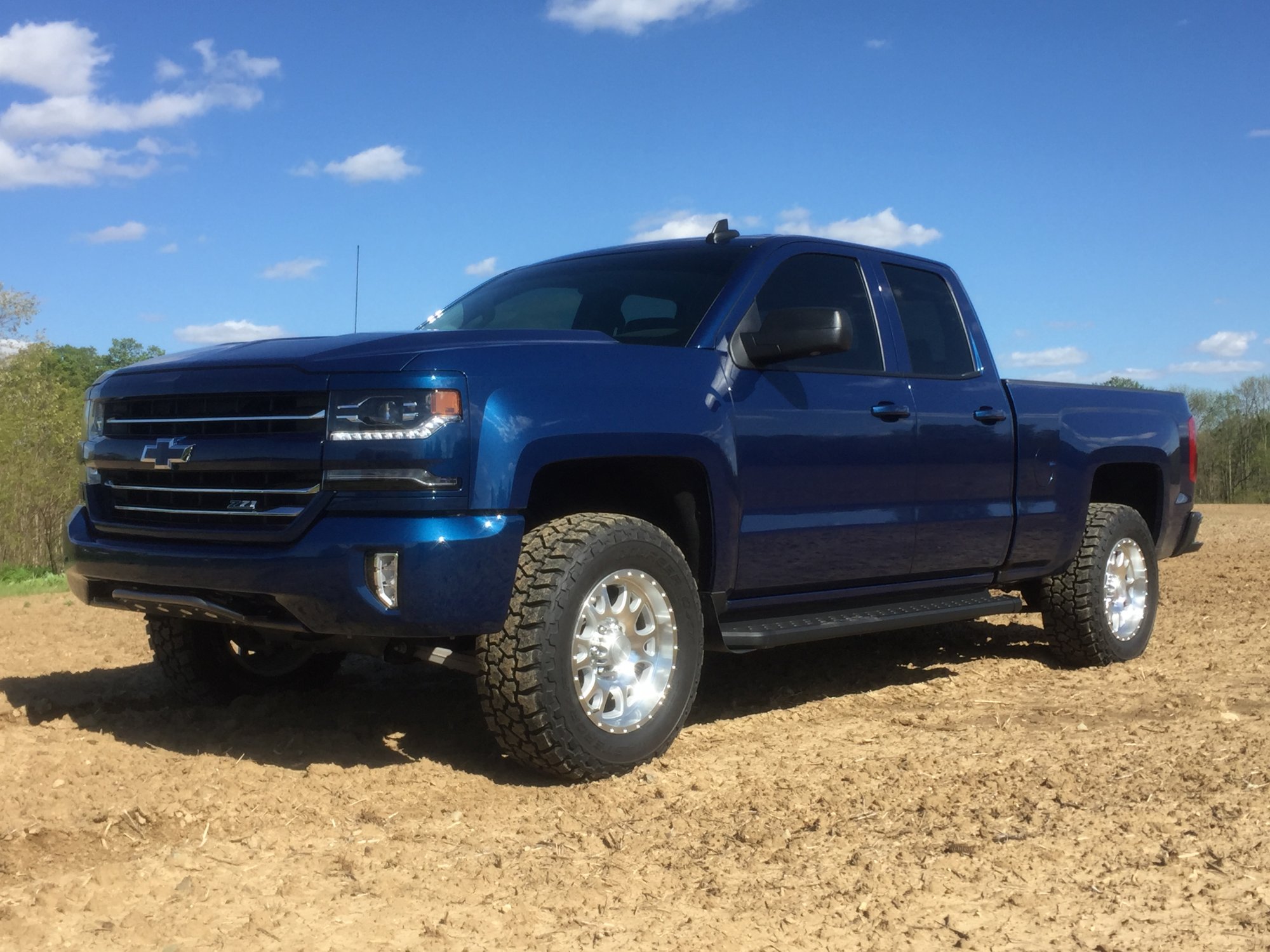

HoosierZ Posted December 31, 2018 Posted December 31, 2018 You can fit 33s with a 2” level. I have 265/70/18 (32.6x10.7) on the factory wheels and 285/65/18 (32.6x11.5) on 18x9 +12 wheels. Several guys are running 275/70/18 on stock wheels with a 2” level.
