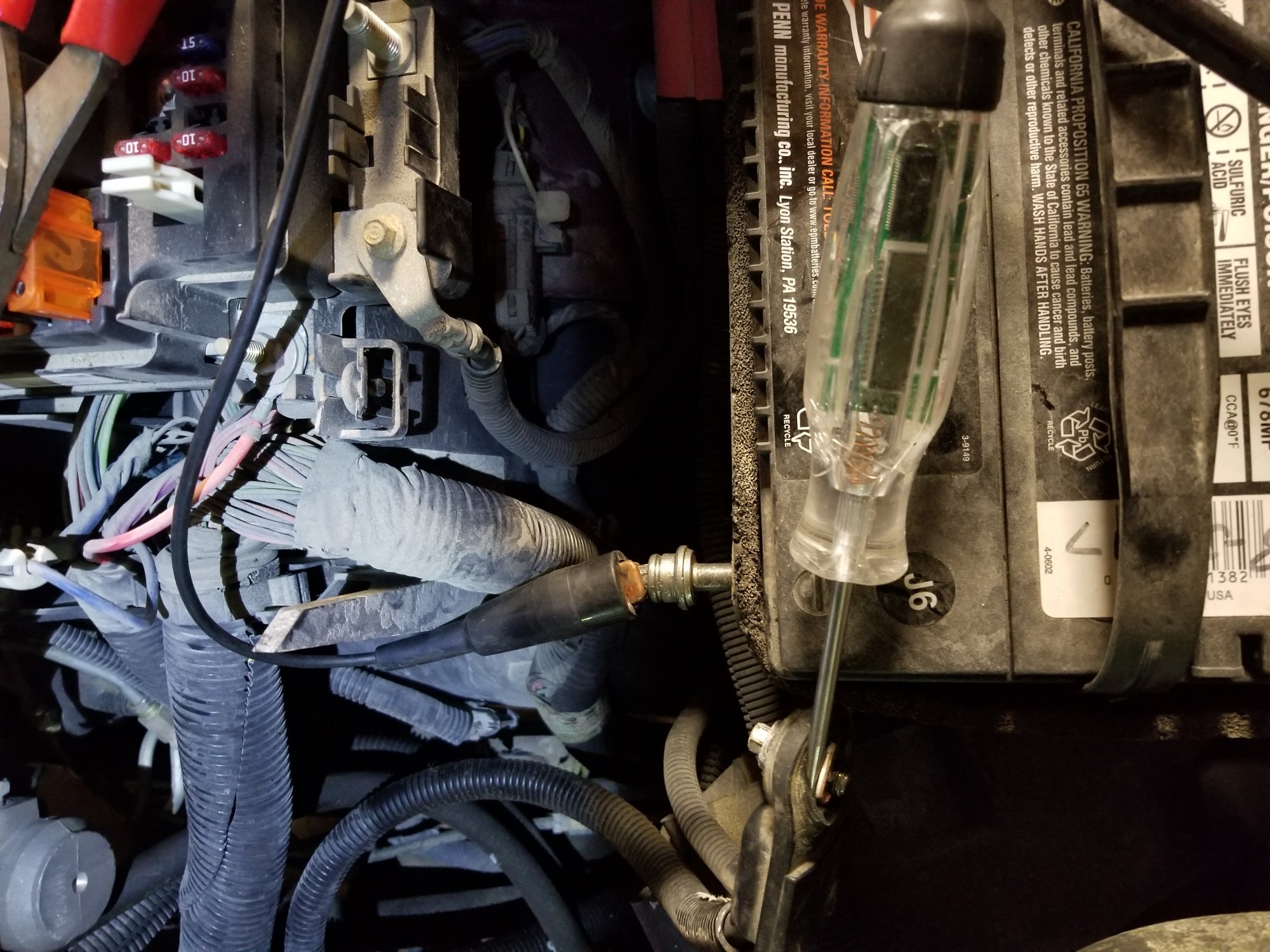

Pulled off negative battery cable, hooked up test light clip to battery and the other end to the cable. ( I made sure all the doors were closed, waited to 15 minutes to put the computers to sleep.  It started at 10.3V.  If I pull the ATC fuse, Radio Fuse, and the TBC fuse then my test light will shut off, but if I put anyone of the 3 back in, I get voltage.

Try to get down to one fuse draw, disconnect connection at transfer case motor,and unfortunately radio connection,a back feed from anyone of these will keep bcm alive
Check that 175A fuse and all the battery cables for corrosion. Sounds to me like there's a high resistance point (corrosion) that got REAL hot when the blower motor was turned on, and made the connection worse.
