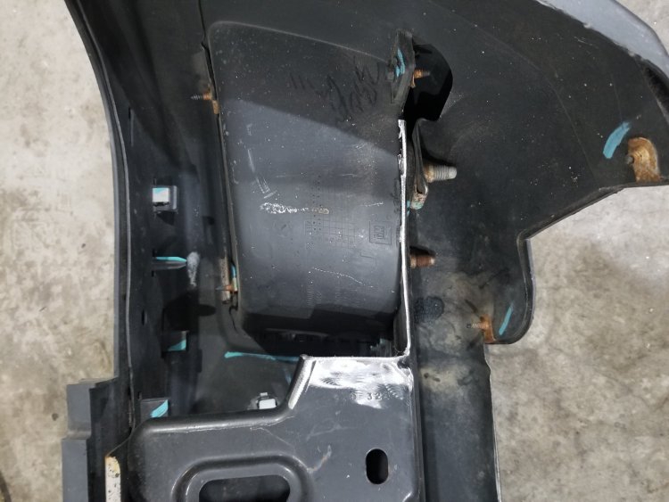

Put a 2014 bumper on my 2013.
Just finished installing a 14 bumper on my 13. Man is it nice to have the step in the bumper. I was so used to it on my 02 avalanche.  Not quite a simple bolt on like ppl say. Had to trim the corner plastic a little, and had to notch out some metal behind the corners so it didnt rub on body. Then had to grind a little on the hitch so it didnt rub bumper. But brackets fit perfectly.  About 2hr job taking my time.
