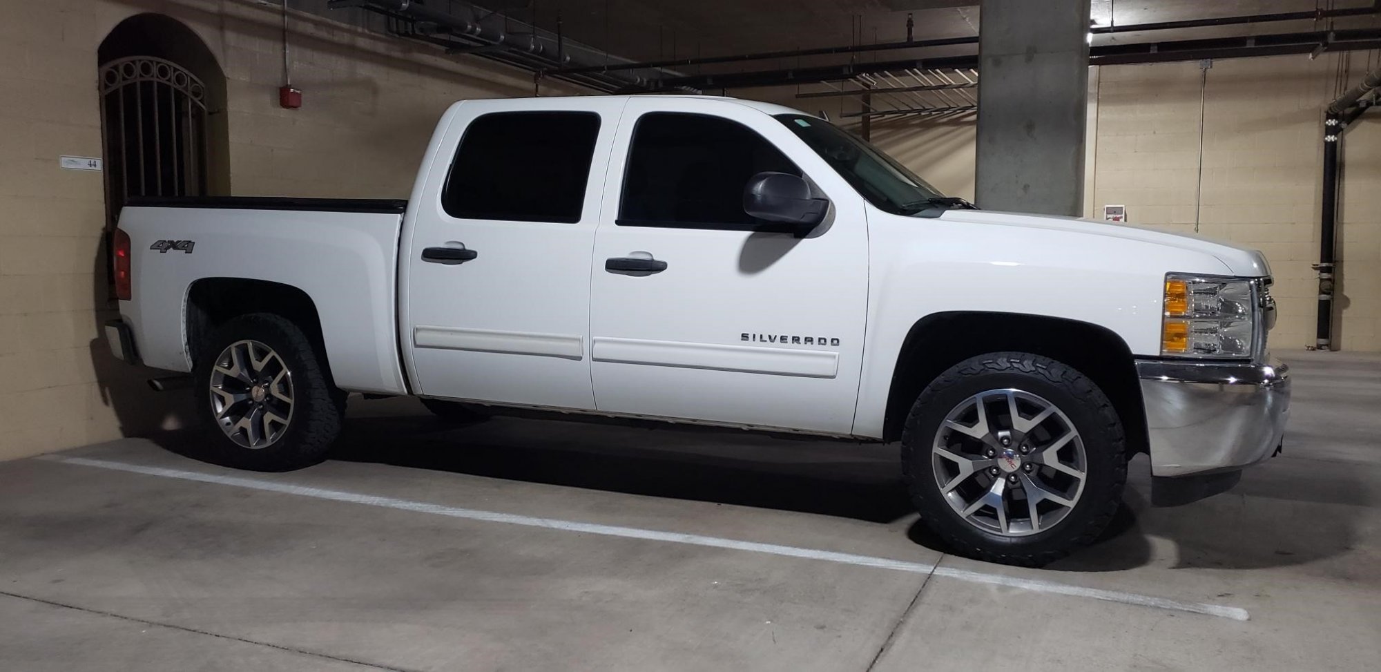

My truck recently came out of warranty, and I am ready to do some upgrades.  The truck is pretty much stock with the exception of some minor stereo stuff and some 20" wheels and tries from a 2016 GMC Sierra High Terrain. Installing a Top Gun Customz 1.5" leveling kit this weekend.
I do a fair amount of towing. I want to give the truck some more power for those times that it is needed.  I tried searching, but I can't find out what most people are doing to these trucks to squeeze some more power from these trucks. What would you suggest?  Drivetrain is totally stock. It has 3.42 gears if anyone is interested.

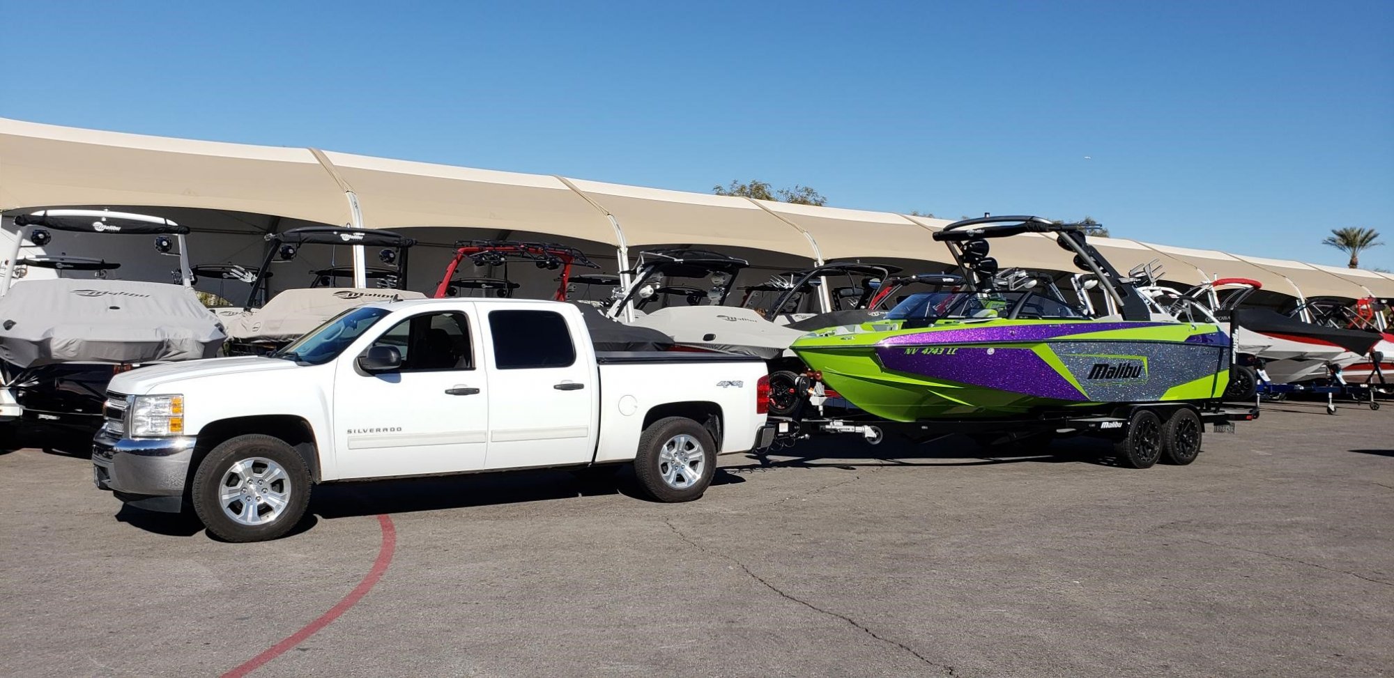

Pic attached of the truck as of yesterday, and a bonus one with the boat behind it.

I'm just looking for some additional power over what the motor currently has, preferably on the low-end. The tires are pretty close to the stock size.  The boat is pretty easy to tow, comparatively speaking, to say a travel trailer, but it is simply just heavy.  I'm sitting around 7k lbs on the trailer and my truck doesn't have as much power as I would like when going up large inclines.
