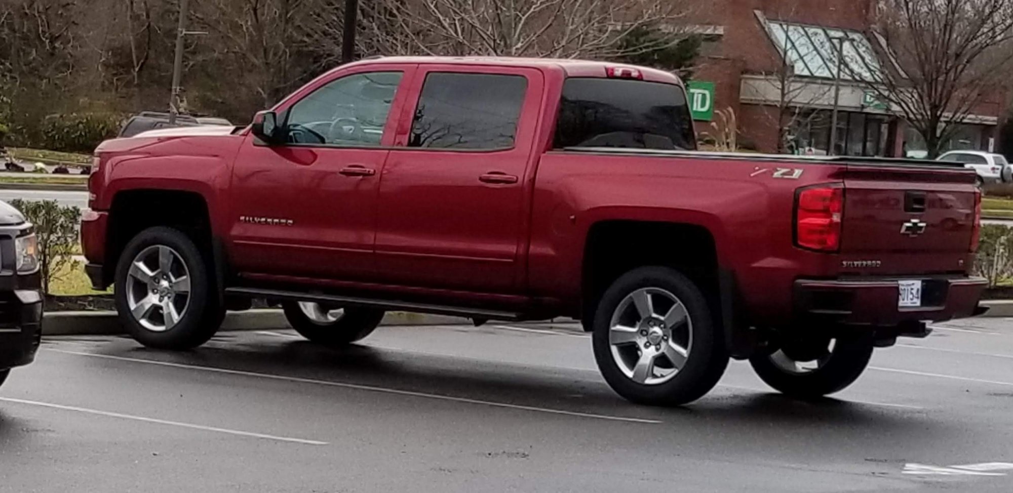

This is the truck, sorry for the bad pic, in this pic it looks like the gap is already closed off but I promise it's not.

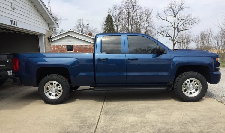

Go to your local home improvement store and pick up a piece of PVC trim board. It’s used for trimming around exterior doors and garage doors. I used a piece of dark brown and painted it with spray can bedliner. One side is smooth and the other side is fake wood grain.

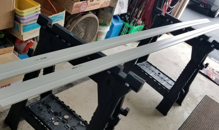

That's the ticket!   Found a nice 8' section of PVC 'chair rail', it's just over 3" tall, one face is flat and the other has about a 1" notched / recessed section that will work very well to let it sit nicely on the edge of the side step.   Grabbed 2 of them, as well as some self drilling screws to mount onto the side of the step.  Funny you mentioned the spray can bedliner also, as I was thinking about using that, I didn't want to risk having paint chip off down the road.    I might also spray the treads on the steps as well, as they are extremely slick in the snow, sometimes in the rain also.

How tall are those tires?

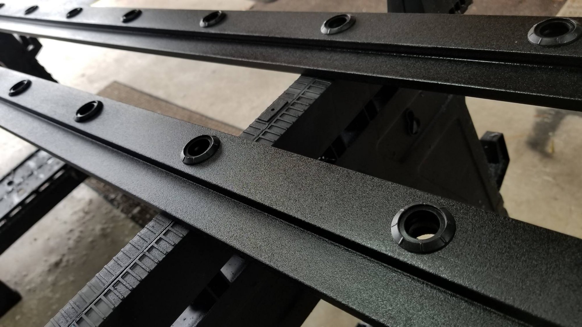

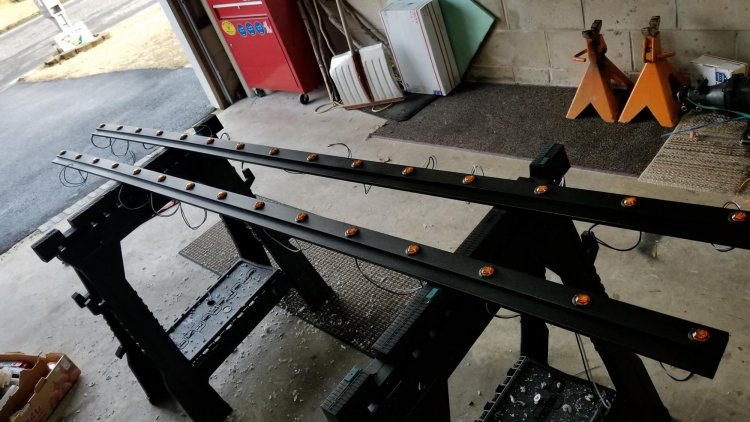

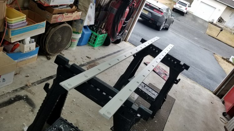

Worked well.   White PVC drilled for lights 6" apart, painted with Rustoleum spray on bedliner (had it in the garage already).   Held to the aluminum running boards with self drilling screws.   Wiring on each side is grounded on the aluminum running boards, and each side has a single +12 wire that I ran back to the trailer plug.  Just plugged into the parking light pin of the 4-way trailer plug for now.
The bag of 50 LED lights was $30 on amazon, and I think the chair rails were about $12 each.   Another $10 or so for screws and bedliner or paint.   So cost about $65 to build the pair.  The lights have rubber grommets which mount in a 3/4" hole.   And I have 20 spares if any of them go out :)
