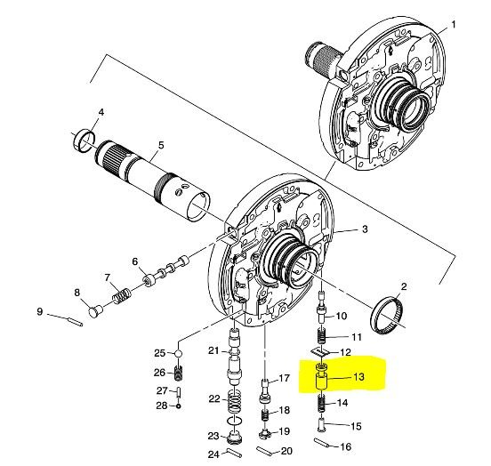

Three - a stuck lube regulator valve in the pump cover. #13 in the picture below.

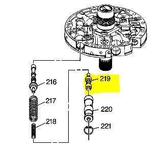

A relatively common issue with the 4l60 is a leaking/ worn boost valve. This will cause a loss of or slipping reverse, and low line pressure rise. I often replace them preemptively in ones I've rebuilt. It's an inexpensive part ($20-30) and can be replaced with just a pan drop. I recommend the Sonnax kit.
carnau: Unfortunately, that's not a 4l60e pump, but below is. The boost valve is the smaller black one  on the left. The larger open hole just to the right of the middle is where the trans filter is stuck into.

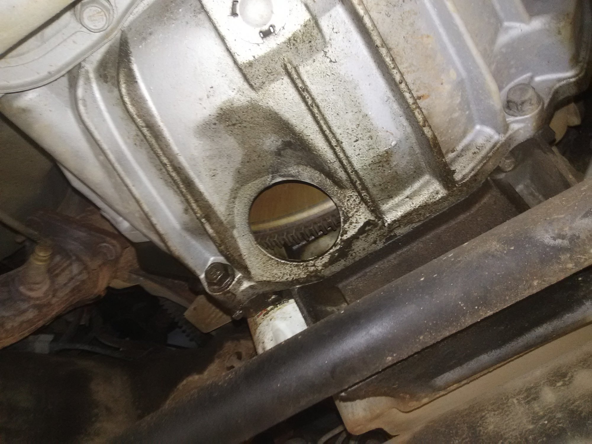

Thank you. I also noticed, finally that I've gotten under the truck that the fly wheel is exposed due to a round plate being missing on the tranny! Curiously, is it possible something flung up inside that would have caused the reverse issue?
No, that's merely a inspection cover/ access. You would have heard terrible noises if anything got up in there. The only real purpose is to inspect for leaks from the front seal, and flywheel inspection.
Okay. Luckily no leaks anywhere. No over heating. It's just that strain to get into reverse even when I can hear it engage whether its fully engaging or not.
No, because even with complete loss of power to the transmission/ aka "limp mode", it will still shift into reverse as it's a hydraulically controlled shift.

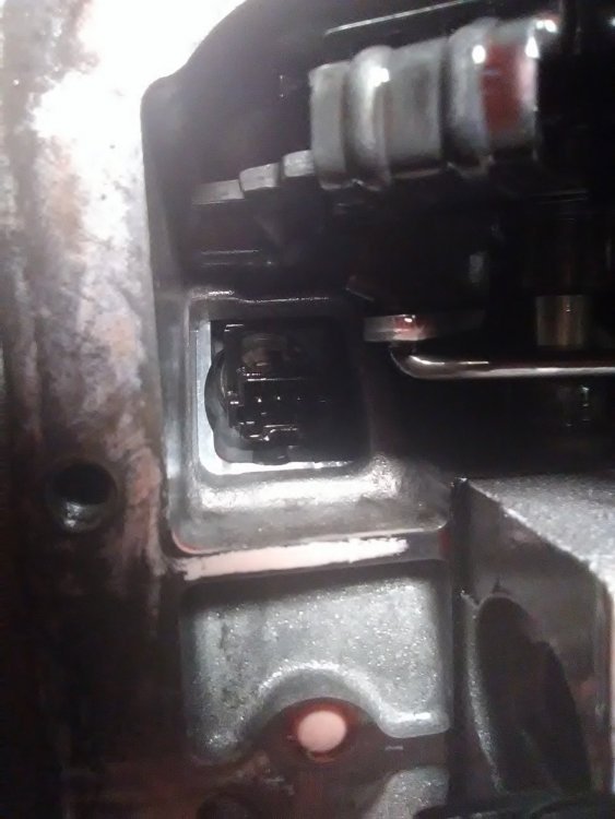

I believe they're T40, but if you're just dropping the pan, you can gently pry the bracket to the side to get the pan down without bending the bracket. It has enough flex to squeeze the pan out beside it.
So I didn't think about it until now' that your truck has the input speed sensor. Ugggh. I think that's almost impossible to remove with the trans still in the truck.

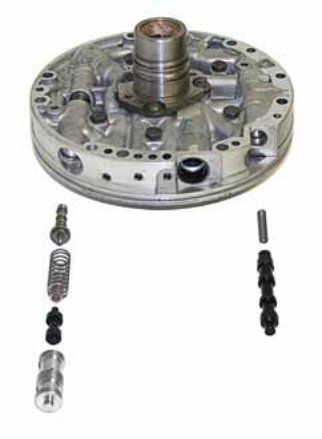

Ha, Yeah. I just happened to have a picture of the Allison one. Still the same spot as the 4l60... Just a few more parts.
Ah gotcha. Ya, sounds it like OP might be have some trouble anyway, as I ignored the fact that his has a input speed sensor (2007+ had this), which pretty much requires Trans R&R to get the boost valve out.
