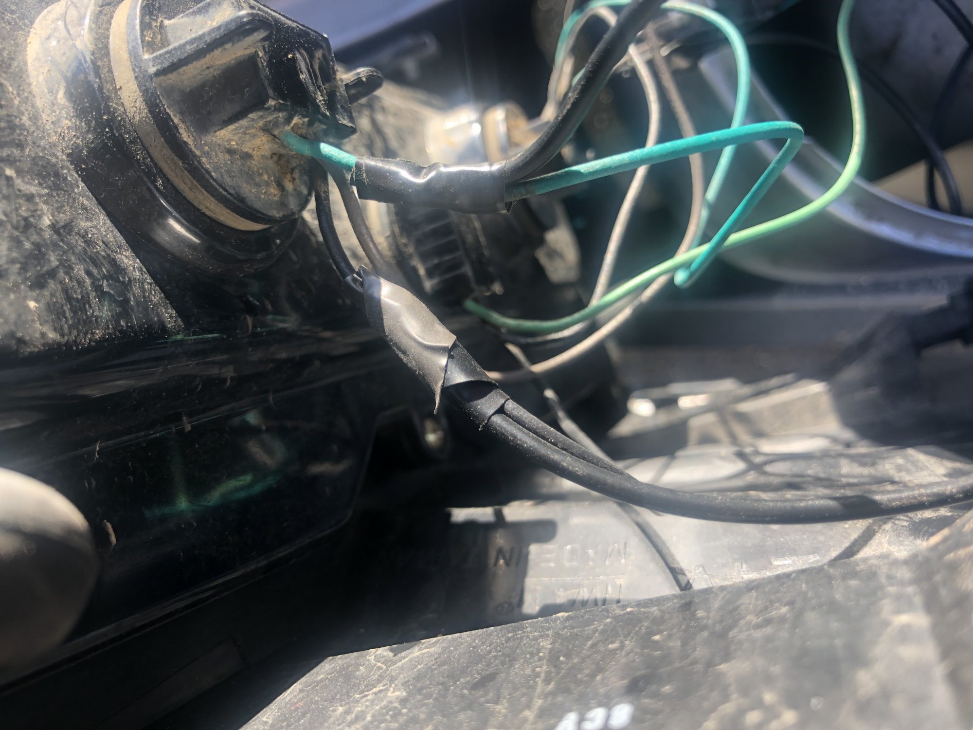

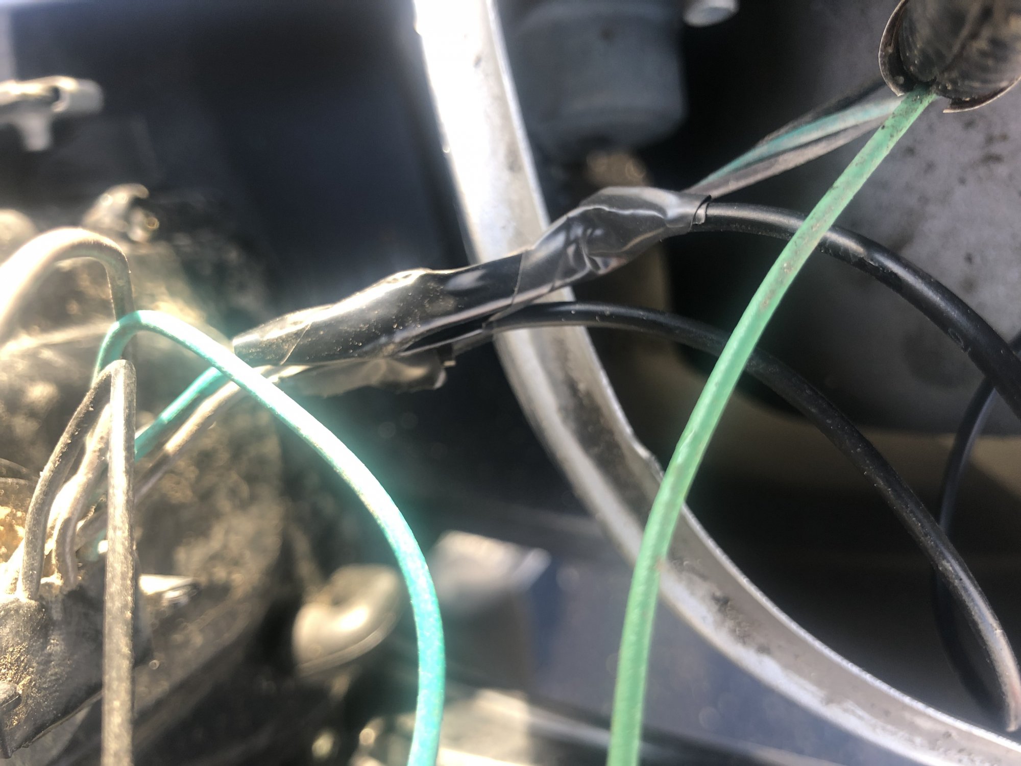

I’m running 2
50w by 20ohm resistors on each side hooked up to the black and green wires top and bottom bulb sockets.
Did id they need to be ran in parralel and only to one socket???  I see where the wires run into the bottom and back out.  So should they both be tied in here together?  This is getting really annoying.
Each positive wire to a bulb need a load resistor. And in my professional opinion need to there own ground. Not a tapped in ground wire.
