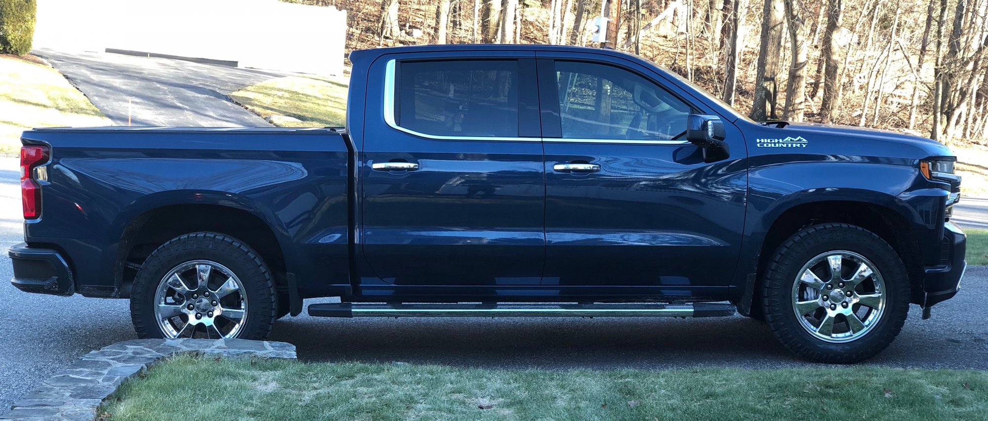

It's not about the size, it's about the angle of the spoke coming from the backside of the rim.  There's a post on this forum that lists all of the rims people have tried so far (see below link).  It's honestly a trial and error process.  Worst case scenario, you could always use a small hubcentric wheel spacer to run any wheel you want.
FWIW on my GMT800 The 2005-2006 CK805 Denali wheels fit fine over my Z06 brake setup, but the 2007-2013 Denali wheels needed a spacer.
On this '19 the CK805s went on just fine with the stock brakes (no Performance Parts BBK yet), but I'd probably need the same spacer if I tried the 2007-2013 Denali wheels.  It really does come down to the spoke shape/profile.
