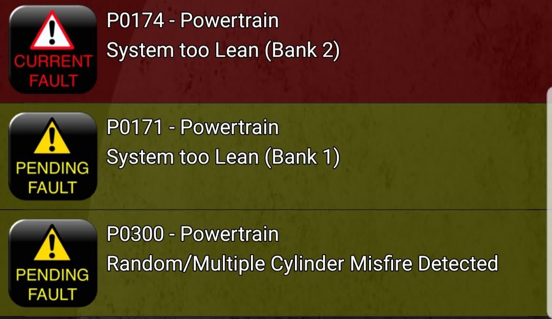

I have a 2003 Avalanche that just started misfiring. It idles fine but around 25 MPH, the motor starts shaking it then feels like someone is holding it and finally lets go and I can get to speed and seemingly does fine. It is throwing multiple codes which I posted a picture below. The spark plugs and wires were replaced 3,000 miles ago with GM AC Delco plugs and wires. When doing them, I noticed some bolts were broke on the exhaust manifold. Lately, I have been having a whistling sound on acceleration when it is cold outside. Is it possible this is a blown exhaust manifold gasket?
More than likely it is a bad fuel pump. But we should do a little more checking because it could also be a clogged converter or other things. First, If you have a fuel pressure gauge you need to be running between 55-60 psi of fuel pressure when at idle or driving. If you don't have a fuel pressure gauge, You can get this one pretty inexpensive and it's always good to have one if you do you own repairs. ( https://amzn.to/2V87yl9 ) If you don't want to purchase one, you can go to the loaner tools at your local parts store and pick on up. But before replacing any parts lets diagnose it further. Let me know that number and let me see what I can do for you.

I'm pretty sure it's the fuel pump by the codes. But I don't believe in throwing parts at a vehicle and not doing the proper diag.

If both sides had broken bolts,a possibility,air leak can cause 02's to go lean,and can you check MAF output,that's also a possibility

Ok so I did a no-no and threw some parts at it. Had my neighbor look at it as well who is somewhat of a backyard mechanic. Sprayed some cleaner to check for vacuum leaks. Noticed the front of the intake appeared to be leaking. Did a water test and it was sucking it in and spitting out steam from the tailpipe. He also heard the same whistling I did. Just got done throwing an intake gasket on it. This engine is pretty easy to work on. The whistling is gone. It passes the water test. The codes are gone and don't come back, but it still has a miss. The intake gasket was bad so it needed to be replaced anyways. Looks like I had two separate issues. Too tired to mess with it further tonight. Tomorrow morning I will test the fuel pressure. Putting on a new fuel filter. I did clean the MAF sensor. The codes may have been related to the intake and not the miss. The fuel pump is noisy when cold so I'm leaning towards that.
