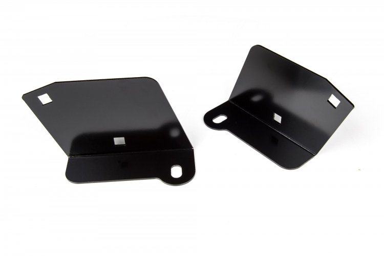

How many people are running the Zone Fender Trim plates? I am running a Motorfab 3" leveling kit on 33x12.5 Toyo Open Country MTs. Naturally I am getting some rubbing going on. So been thinking of getting the plates to get them to clear. My only concern is that I still wont be able to get them fully lock. Does anyone know if it is even possible to get 33x12.5 to fully lock on a Motofab 3" level, and if so what all is needed to make it happen?

Yea I figured that, I guess my question was, would those spacer trim plates work, or would I need to cut more in addition to these basically.
27 minutes ago, boostnls1 said:
Thank you man!! Thats exactly what I was looking for! That doesnt look too terrible honestly.
Nah, it's not bad, I did it on my 2013 Sierra in order to run 20x10's and that was with a 4" lift.
Have the plates in the mail. Once I install I'll let you know how good they work. Running a 33x12.50 on a 10 wide -25.  May not be enough even for the -25.
