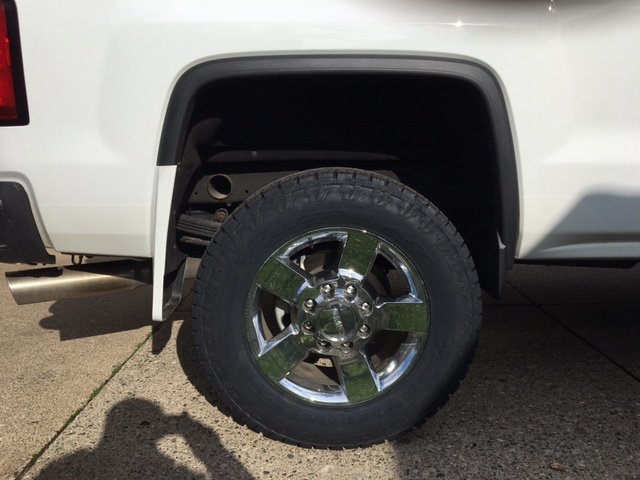

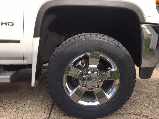

So I am new to the forum and have already learned a ton. I just bought a new 2019 Chevy 2500HD Duramax Crew Cab Z71 LTZ. I would like to raise the front end to level it out but I am afraid of the ride that a leveling kit will leave me with. I also want to run stock wheels (20”) and tires. So my question is, what do you think about the RC lift, and will my truck look stupid raised that much (3.5”) with stock wheels and tires? Any advice will be appreciated!!!

See that’s my hold up. They don’t look undersized on the back end and all I’m really doing is gaining that same height on the front end. I just dont know what to do.
