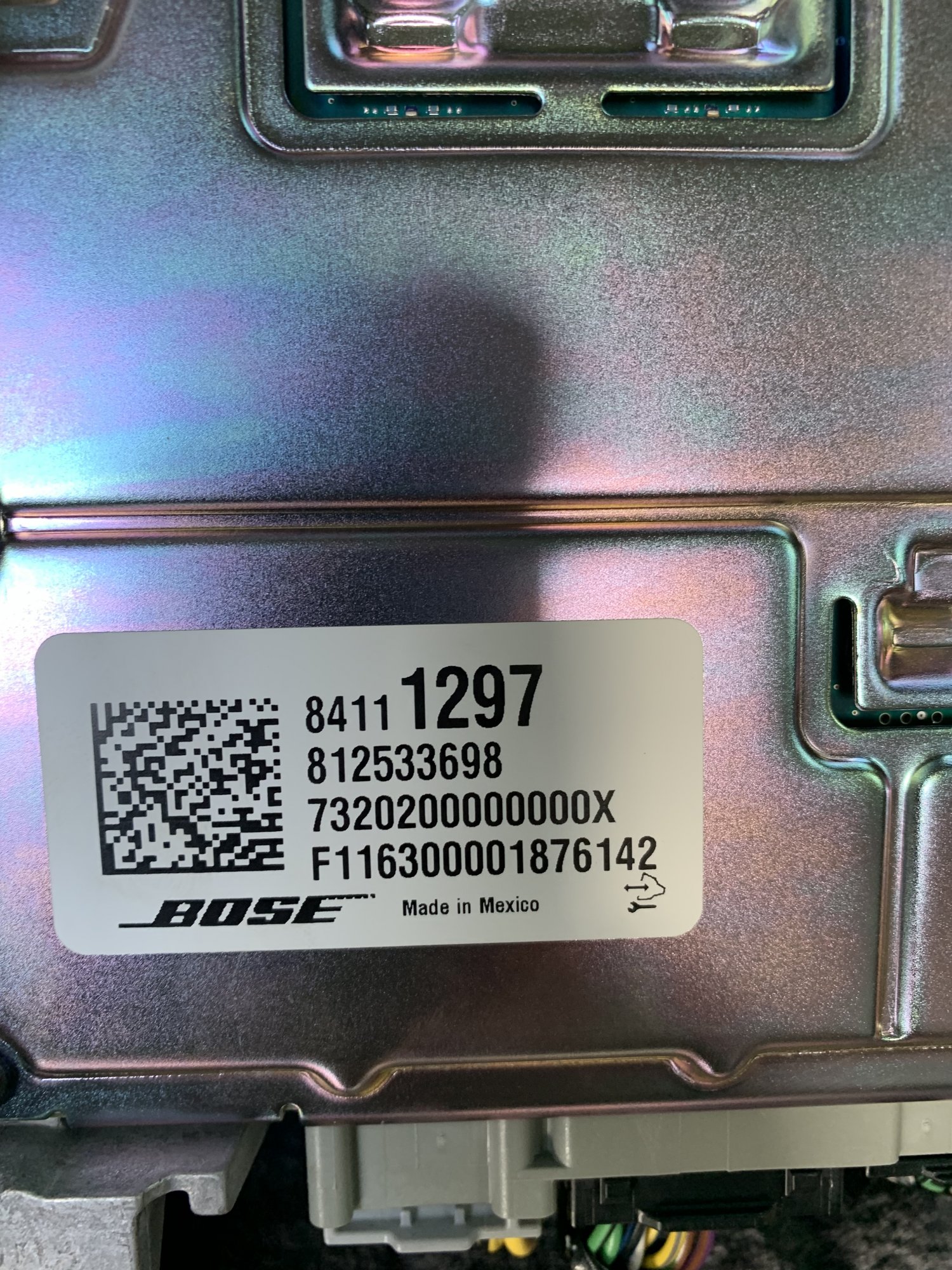

Here’s a pic of my amp
Is the Bose with sub the same amp?

There is no amp on non Bose and it’s totally diff. Wiring the whole setup is diff. ANC is on the 6.2 trucks. Best bet is aftermarket honestly.
