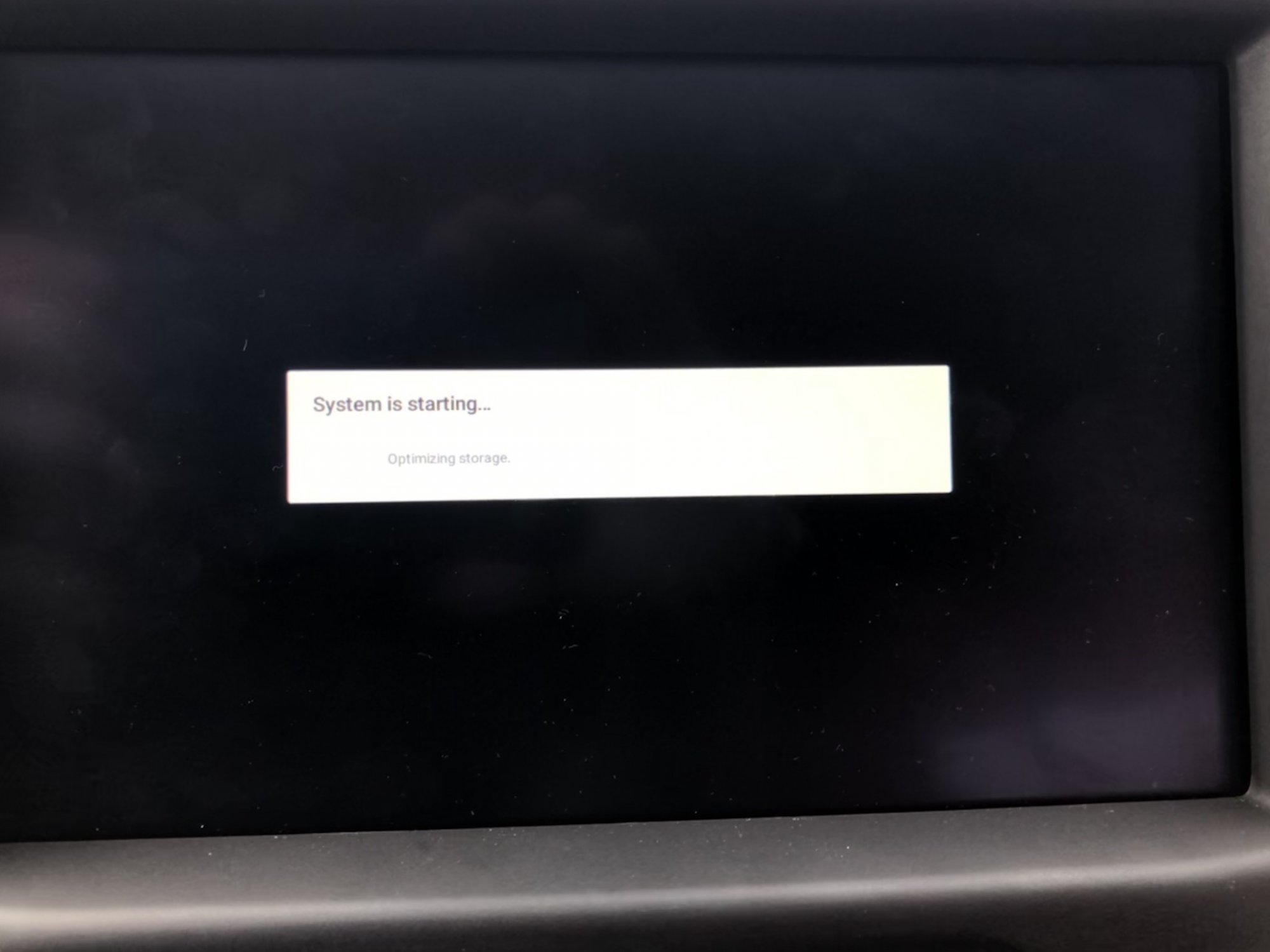

I’ve attached a pic of the latest thing the MyLink system is doing while I’m driving...”system is starting” message that randomly pops up on highway speeds.
I get the same screen at startup every morning. Normally only get it after the truck has been parked several hours. Did yours start there and progress? After all the updates, I am a block or two down the road before all systems are working.
I still say Chevy has fixed very little, just covering up the issues. I am waiting a few months, trying to give Chevy a chance to fix mine.
