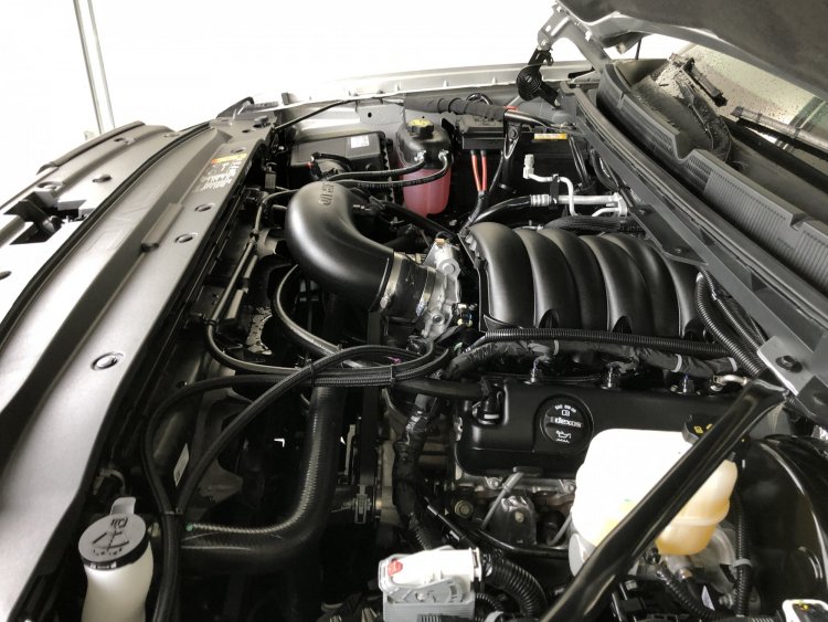

WS6FirebirdTA00 Posted April 21, 2019 Author Posted April 21, 2019 For those asking, install a catch can... This is after about 50 miles. Elite E2 mounted at the washer reservoir. 6800 miles on the truck. I was on it a lot those 50 miles. I did Seafoam to hopefully run through the same path as the oil to clean the accumulation in the manifold. I can still smell the slightest oil burn at idle. My WS6 decel always gave me a good whiff, but idle vacuum was poor with the cam. I can see a decent fog when I pull the can off, so I assume at idle some of this lights stuff just passes through. I will see how much it catches this week, about 250 miles of driving.
