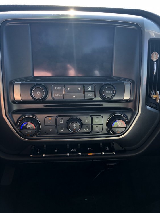

So I started my truck with the remote start and got In my truck and the screen was off and couldn’t manage to get it to come on nor get my CD (old school I know) to eject. It’s been 2 weeks or so and not having any luck. Every now and then I can change the station and control the volume with the steering wheel controls, but that’s it. No Bluetooth. I have watched several videos on the YouTube. I have replace the fuse and checked to make sure the connections behind the glove box were good. The Chevy house won’t warranty it bc I have 45k miles on it even though I’ve had under 3 years. They said it’d be around $2k to fix it.
Just curious if if anyone else has had this issue or know of some way to maybe fix it or an after market system that would be easy to install.
Might just say screw and get an AT4 if the wife will let me, but I finally have this truck the way I want it.
Please Help.
