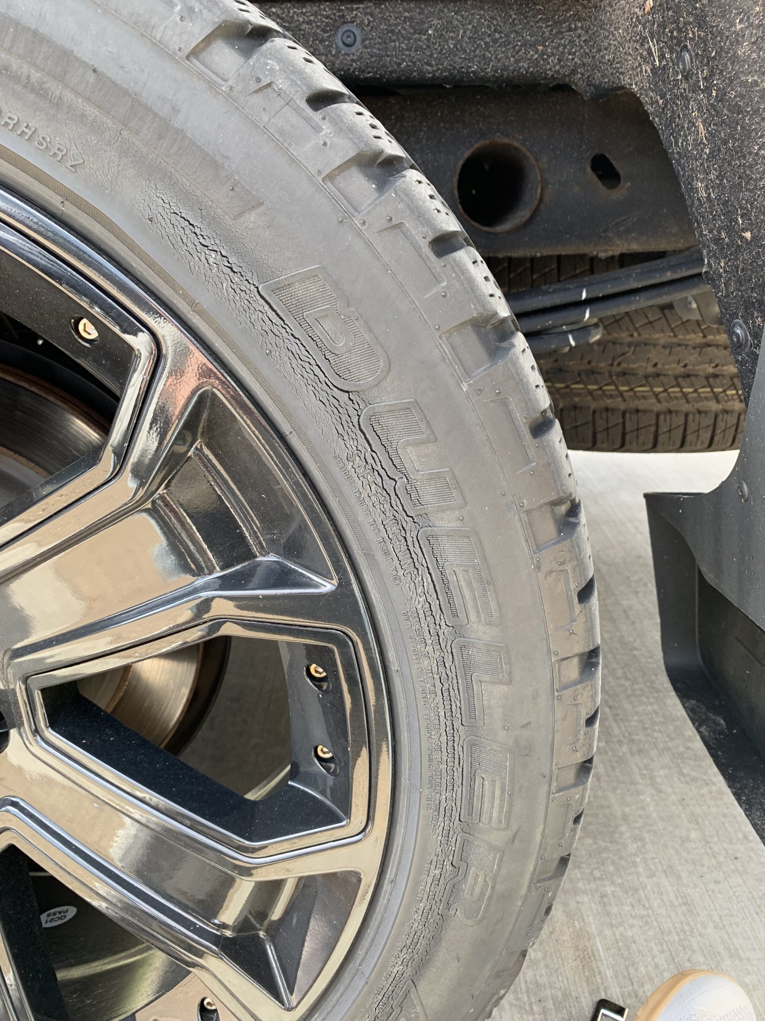

Been noticing the sidewalls of my factory tires starting to crack and now bulge a little bit.  These are the factory 22” Bridgestone Duelers with about 38k miles on them.
Safety issue or normal for these tires?

Wow 20% is sweet. I dont have any stores near me unfortunately. Here are pics of mine that I just took. Again.. only 3 yrs and 30k miles..21e4748af4b8d95e870adcb0d15b00d1.jpg8d47c2a4fb1611b6fafabbff44349c49.jpgae70b3ac9c79a53bcf82ba95c1a88c16.jpg

It’s a major safety concern, they’re ticking time bombs. This is why I always recommend to ditch the oem tires and shocks, I’d get rid of them ASAP! If you’re looking for all season tires I’d look at Michelin Defenders, smooth excellent riding tires that are now designed to handle more power and torque from newer trucks. Excellent tire!

With the placement and size of those cracks, I'd call that a safety issue aka pending tire failure with the clock ticking.

I drove my Dueler RH-S's for 76k miles.  Had these type of small cracks starting about 30K miles, first in the tread and later around the bead.  At the end of their life, the cracks were much more significant than the ones shown here.  Drove it in 110F heat and -15F cold, over ice and snow and bad potholes, etc., with several trips up to the ~97mph speed governor.  Never got any worse or had any blowouts or flats.  So in my experience, this type of small crack shown here is a non-issue.

Yet another IGMO screams "Ditch the OEM tires and shocks!!" from the hilltops.
Or not . . .
Whoops, Michelin makes factory OEM tires for Silverados and Sierras, just like Goodyear and Bridgestone.  With the TPC code stamped right on the sidewall.  Guess you'll have to only drive Coopers then, using your logic, as they are the only manufacturer that doesn't have their tires factory installed anywhere.
Go ahead and rip off those GM struts and shocks.  And probably replace them with Monroe (made by Tenneco) or Rancho brand.  [Because that's who made the factory ones in the first place.]

It’s a case by case type of thing. Any tire dealer could call Bridgestone customer service and see if they can get you a similar credit.  They might not all take the time like Discount Tire did, though.
I decided to take them up on the offer and get a set of the Continental’s, to be installed tomorrow. I figure I needed new tires by next winter anyways, and my family’s safety is worth more than a grand.
