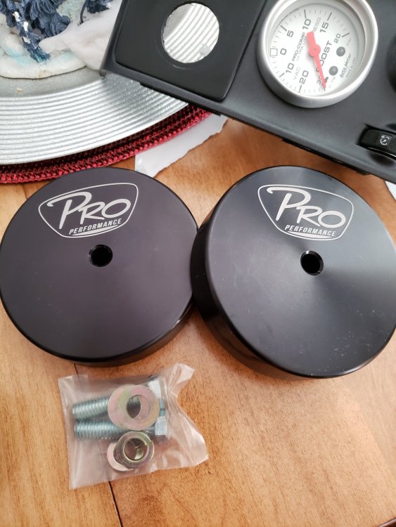

Yes I have the over the leaf helper bag with billet 1" spacer on a 3/5 lowered truck. What lower amount and kit?

So if you see he was at 7" and I am only 5" so the 1" spacer allows me to run little more air and be more in the middle of the bag travel. Also protects the bag from stretching.
Ride quality is much better and I have mine set to just lift the rear end about 1/2". I like the slight rake look but also helps on bumps. And with my power level I have the over leaf removed and assasin traction bars so the truck wants to squat faster and hook harder. The bag is huge help.

Where do you get the billet spacer from ?
