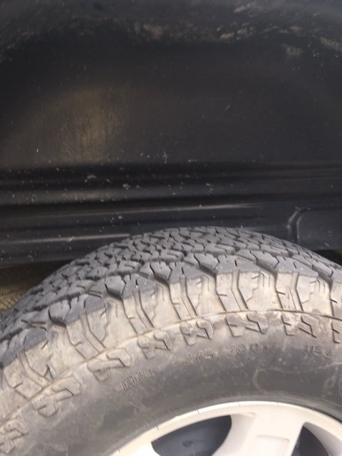

I also believe i have rear husky wheel well liners but not sure if there is a way to tell by looking at the outside (Without trying to remove them as they are tight fit)

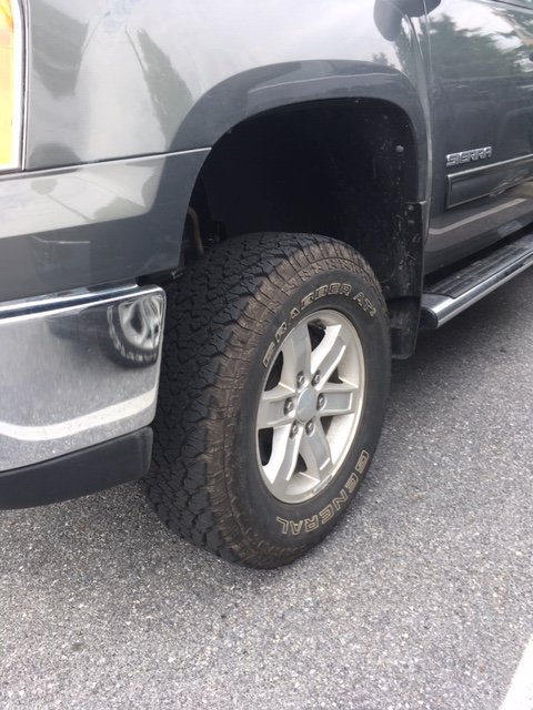

Here are some comparison pics of a newer 4x4 and my 2011 SLE.
Yeah there is your spacer above the coil in the front.  If you look in the back it probably has a 2.5" block in it.  That's all they did.... my buddies 2011 sits exactly the same way and probably has the exact same lift.  I only leveled the front on my 13 with a spacer between the control arm and the bottom of the strut and left the rear.  Sits perfect.
 Should look at the cab mounts too.... almost looks like a body lift in there from how the strut is sitting in relation to the fender liner in the front.
