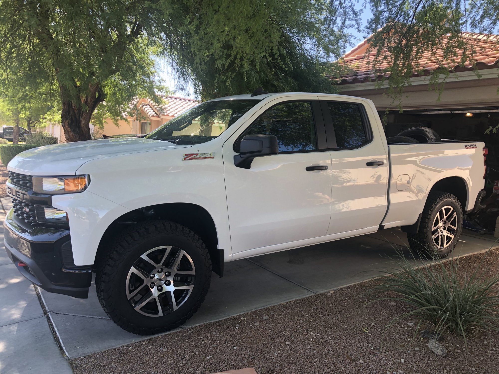

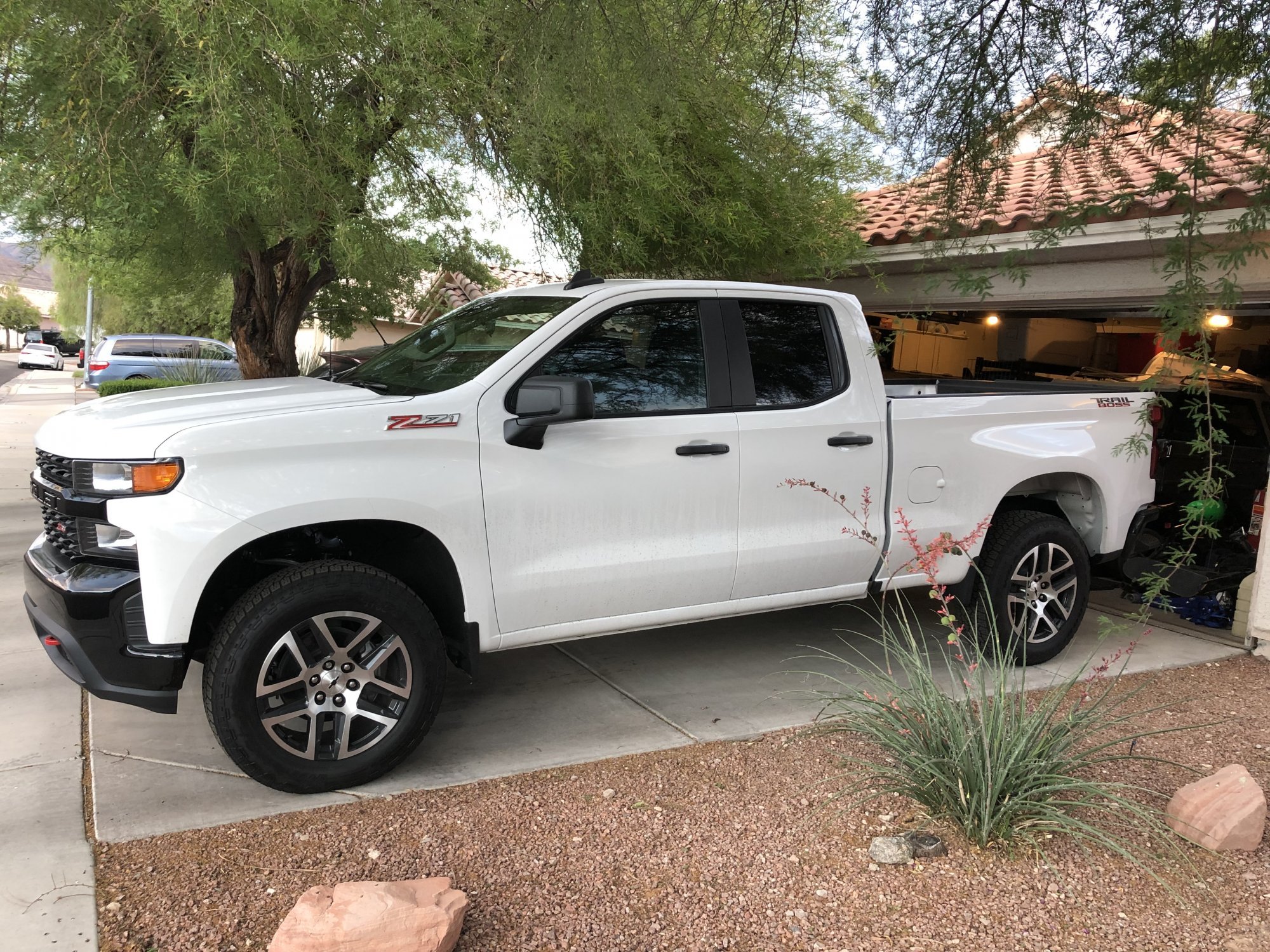

I just got 285/65R20 BFG KO2’s the real size is 34.5x11.5R20. I plan on putting them on the stock 20” wheels this weekend I don’t have a lift or leveling kit on my TrailBoss. I’ll post back if they rub and before and after pics.

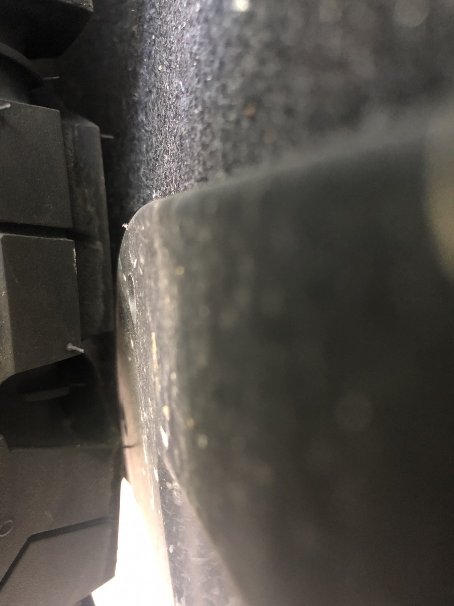

 The BFGOODRICH 285/65R20 on the stock wheel and no leveling kit or lift kit at full lock I turned both left  and right and went forward and reverse in an uneven parking lot they don’t rub I can fit a nickel in between the tire and the mud flap they might rub in a little more of an off-road condition I will find out when I get a chance to go out.

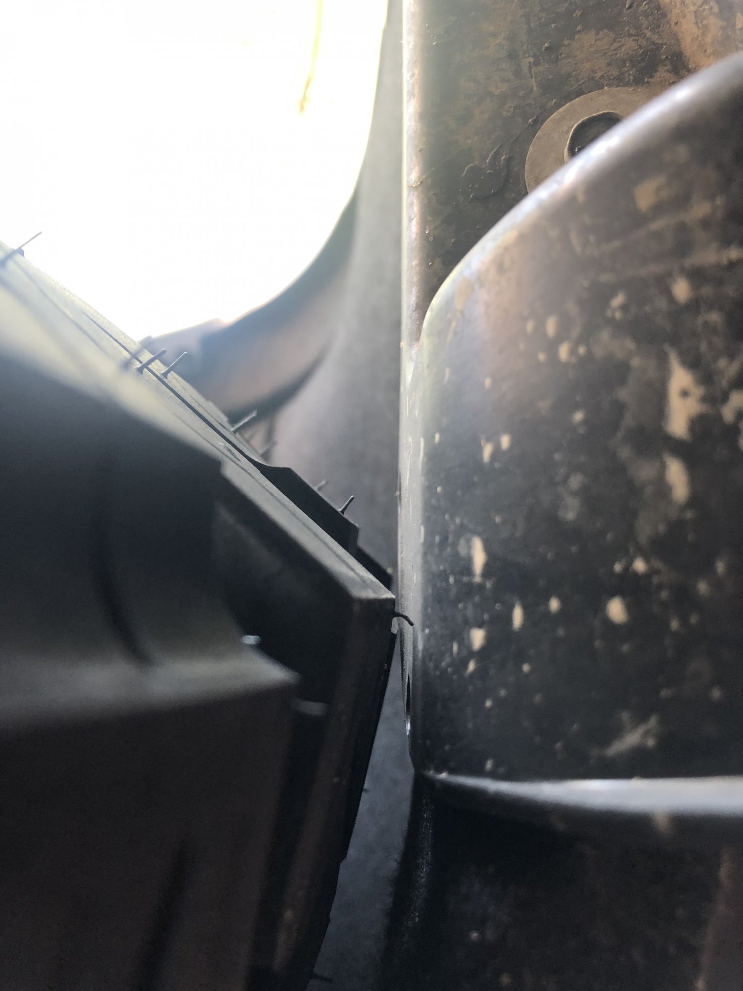

I did get a chance this weekend to put it through a little harder than pavement test and at full lock in reverse on very uneven ground they did rub just enough to hear them but nothing that was catching to much to need to do any modifications in my opinion.
