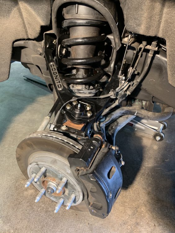

I have cognito and don't agree. They are not perfect but the build quality is there. They do need to be checked for frame clearance at full bottom, and just need a small notch to clearance. Ball joints are a standard  widely available variety that can be upgraded easily.
 That said the uniballs you mentioned are great, but start in the $800 plus range and you will have the increased noise and maintenance of a uniball. not a bad choice but be aware your not going to install and never touch again.  And if you don't have good extended travel shocks a uniball is overkill IMHO.
the other options are the cheaper $300 range arms that are almost all junk. So for $500 the cognitos are a viable option, knowing that you will probably need to upgrade the balljoints at some point and slightly clearance the frame during install. Strength wise they are well built, strong arms.
