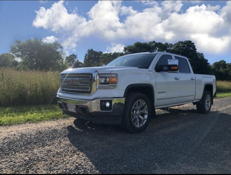

so here’s the truck, purchased on Memorial Day.
Looking to run a 285/65/20 ko2 on my stock wheel.. with a 2” level.  I’ll end up doing a 1” block on the rear. But for now the 2”level is long overdue.
any pics of this setup on this wheel? I’m curious as to if it would fit. I know a 275/60 will. A 275/65 I think would too... However I question the 285/65/20.
Or do you think the extra width isn’t worth the extra money per tire, and stick with a 275/65

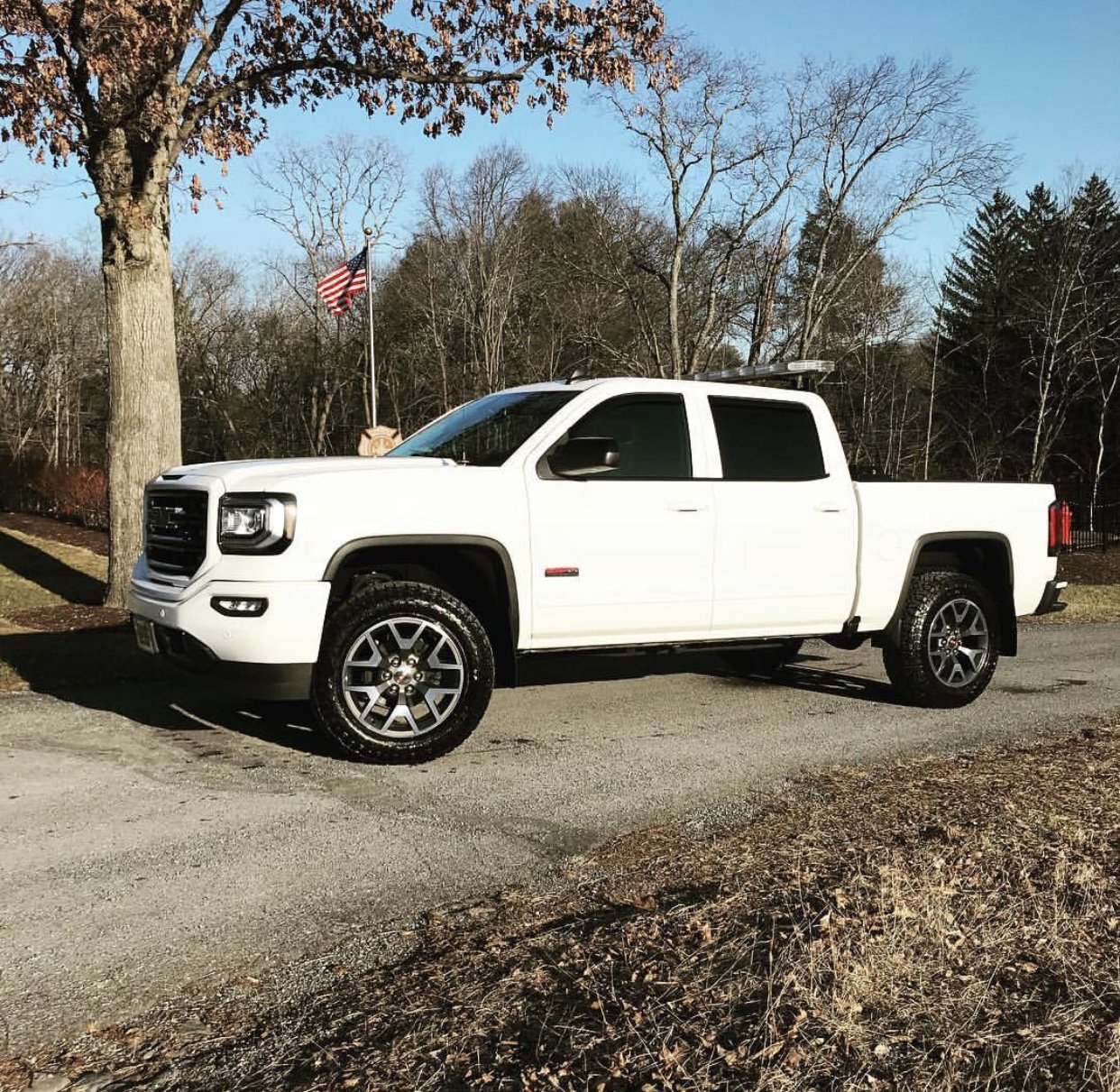

This is only photo I can find that’s a clear side shot. This is with the above set-up and maintains about a 1/2” rake, but it appears level and stance is just right.
