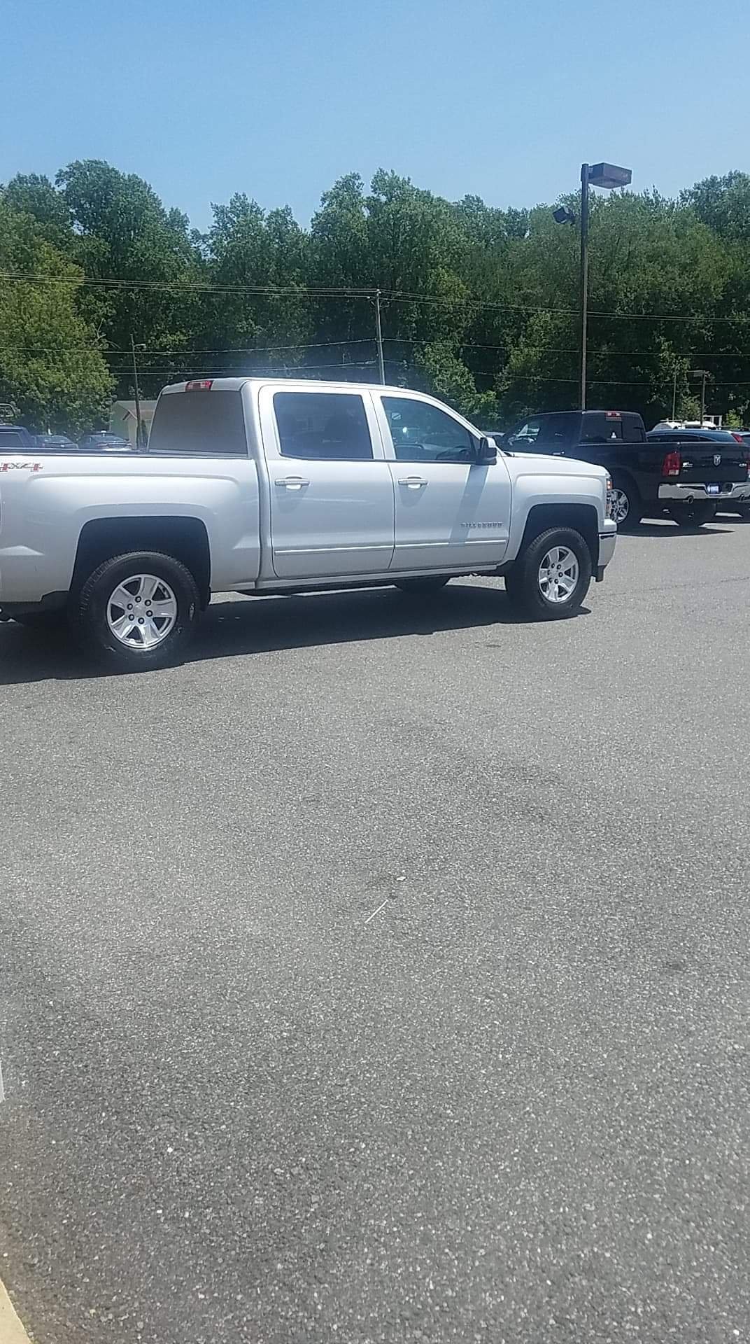

That looks pretty tight.  I'd assume stock suspension.
Its definitely leveled sits higher than my coworkers in the front
