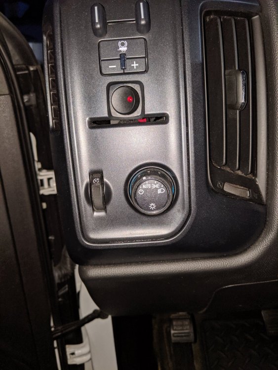

Anyone know how to install fog on a '15 6.0 that doesn't have any? Want to connect to the factory button on the dash. Also, although it's there, it doesn't push in. It moves a little but it's like there is something behind it blocking it. Anyone know what that's about?

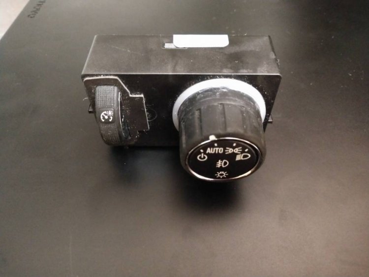

You don't have the right headlight switch for the fog lights. The switch for the fog lights has the fog light symbol in the middle and does push in (see the attached picture). I looked up the part number for the one I have (84154108) and it's only a $34 part.
Keep in mind, it's not an actual on/off switch. It is wired back to the BCM and triggers a relay. I would do a search on here to see if someone has successfully added fog lights using the OEM switch. But might be more trouble then it's worth. IMG_20190807_062057506.jpg
