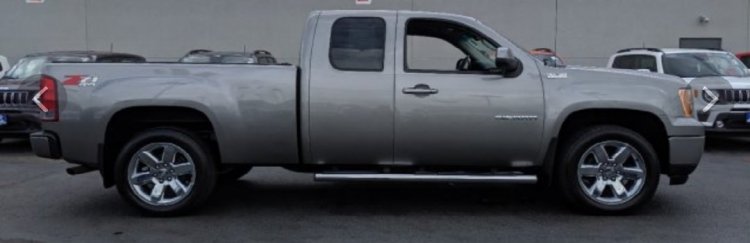

Same truck as my 2012 just a year newer. Same color, wheels, Z71 and extended cab.
