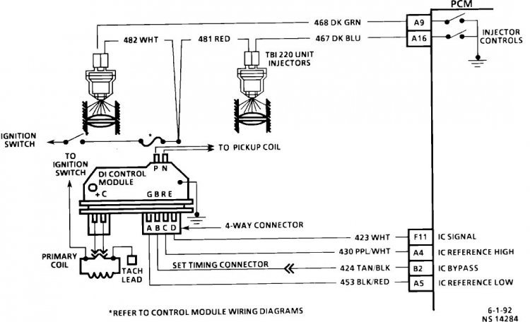

I just came up with this in a quick search. Glancing at the diagram, it looks to be a ground-side switched circuit. YOu'll need to see if you have power on one side of the plug. If you do, you've either got a wiring problem, or the ECU isn't providing a ground signal to the injectors. This could be a computer power, ground, or input problem.
EDIT to the above - you should see 12v on BOTH sides of that circuit all the way to the engine computer with that particular plug on the engine computer disconnected from it, key on engine off. That will confirm circuit integrity from the ignition switch, all the way to the computer. If you have 12v on both sides of the injector plug (key on, engine off), and pins A9 & A16 of the PCM (which you should see), you'll need to investigate an input problem.
I've forgotten what inputs can kill injector pulse - possibly if it thinks there's low oil pressure  (I know this will kill fuel pump control - not sure if pulse, too), or vehicle is in gear while attempting to start. Wish I had access to the service info. Lack of FREE info drives me friggin nuts ...
