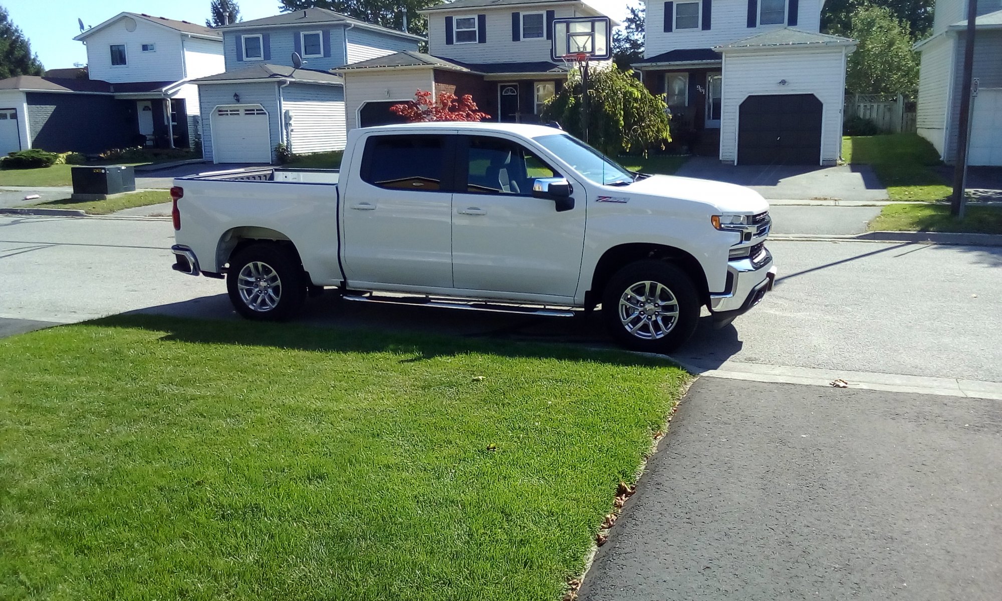

4.25 inch U-Guard brand steps from Costco delivered right to our door in 2 days....Last U-Guards I bought were on ok Silverado for over 8 years and still stable/brackets firm an no issues ...Westin knock-offs or cheaper version--- okay with me
